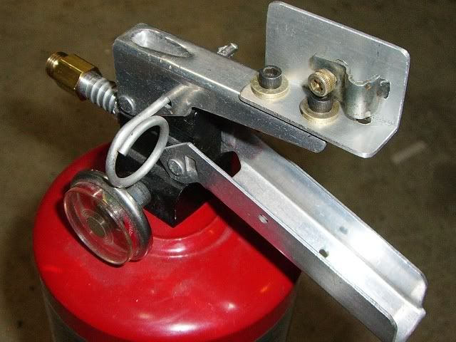

These are big(10lbs) extinguishers that carry a variety of ratings including Coast Guard and aircraft types. They are hand held with a handle type firing head. The head uses a AN- style, O-ringed, discharge-fitting.
I figured I could use one of them to serve as my fire safety system installed in my track car.
I had to modify the head to use a pull cable. I also had to modify the discharge fitting to adapt to my plumbing.

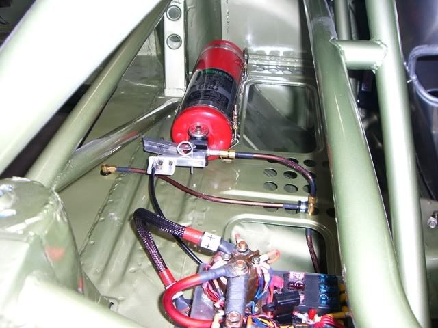

I used 4.25" band clamps to mount the bottle behind the driver's seat.

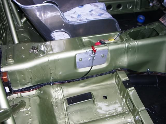

I purchased a Fire-Safe systems pull type cable and installed it in the hand brake location.

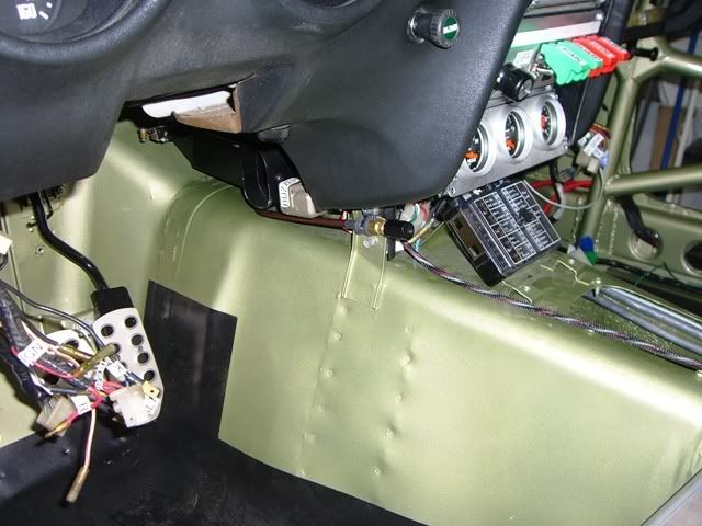

I used copper tubing and compression fittings to plumb the 3 nozzles in the driver's area, the firewall, and the fuel tank area.
