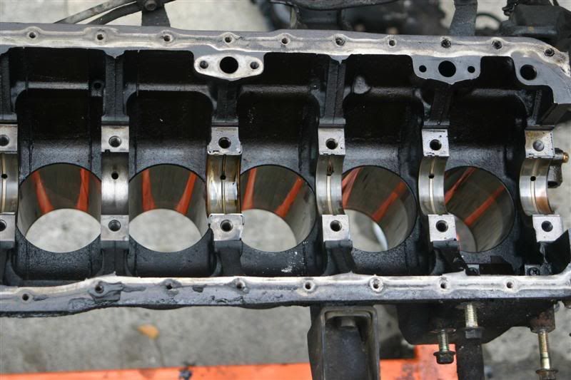

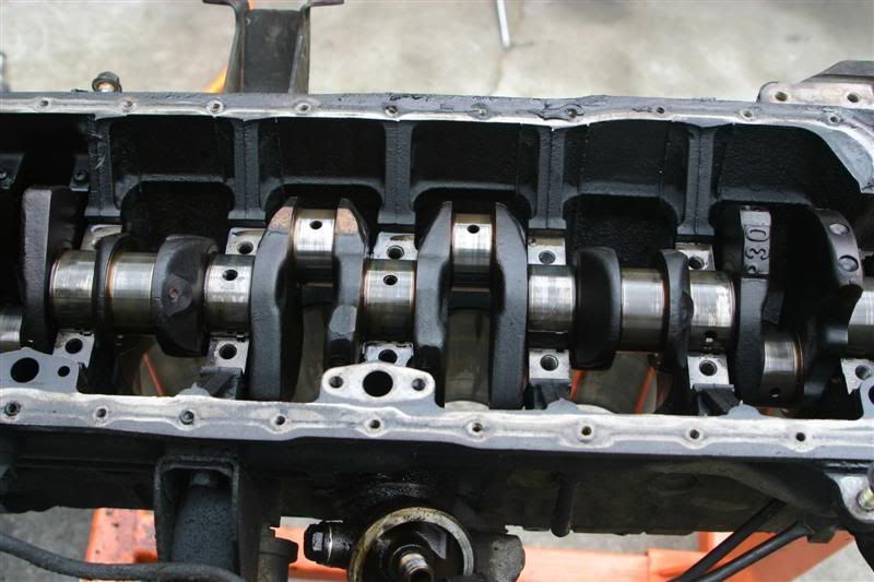

Ok this is the engine from a junkyard that had a 280zxt with 190k on it.
It had a automatic tranny and was a 83.
These pics are to show ware on parts and to get some ideas on how well the engine was taken care of.

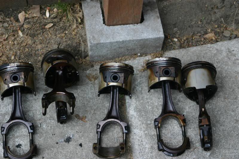

I pushed the pistons out the top of the engine b/c there was no compression lip to speak of. Out side of yellowish ring markings the cyls look great.

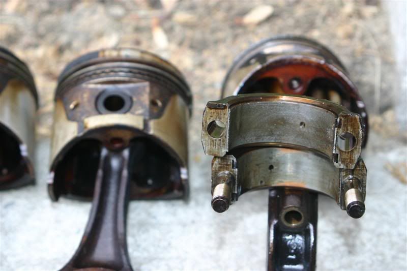

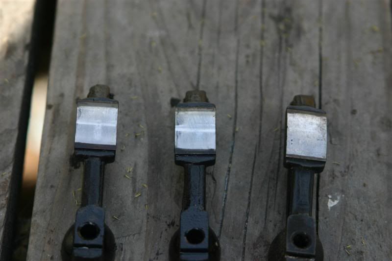

Personally the bearing look "cooked". This is after I had wiped them down.
Photo of piston skirts. (Yes I'am aware of setting these things on concrete I was very careful) BTW Kids started playing with them saying that they were trophies. Watched "Cars" to many times. Told my daughter that they were pistons and she asked if she can still call them trophies and I said sure why not. :) I love kids.

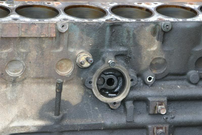

One last thing. What is this sensor? I would search for it but at the moment I call it thingy. It is not into a oil passage or water jacket.
It is just into the block.
Looking forward to your insight on over all ware and what to look for during restoration of engine based on ware.
Just wanted to let you know that the sensor is called a knock sensor and time for new bearings. I am not terribly educated on the actual machine work or current state of how well or not the block is, so I will let some of the guys here that have been there and done that many of times to comment on the actual status of the block and crank.
Good luck on everything. I'm currently trying to put one back together after getting screwed by a machine shop.
Hey thanks for weighing in:). Funny thing is I did not know that any of zx's came with a knock sensor. I will have to search that. That's kinda what I thought but I swear I never heard of one on this engine.
