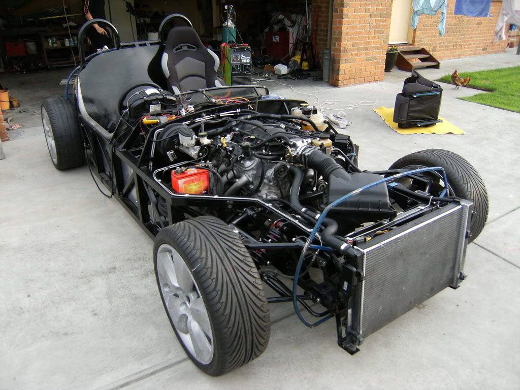

Guest s20703 Posted June 20, 2008 Share Posted June 20, 2008 The diagnostic was plugged into an obd 2 port on the actual loom. I may have got ripped off when the guy said he deleted the vats system. Payed $200 not knowing it was so easily removed. Ill try and get into contact with him. Im wondering now what the actual PIM does as it acts as an interface between the body control module and the powertrain control module in the SS commodores and thats what the code was complaining about. Do the american pontiac gto's have such a module? Is it true that we may have to have the PIM and BCM back? Thanks Heres a pic of where we are up to on this car (it is going to be fully street registered Heres a pic of the single seater we completed that is fully street registered ( supercharged v6 with water to air intercooler and 14 psi boost) - goes as it weighs 750 kgs Quote Link to comment Share on other sites More sharing options...
73DatsunZ Posted June 20, 2008 Share Posted June 20, 2008 Holy... thats awesome! Is that a GTO/Commodore gauge cluster too? Quote Link to comment Share on other sites More sharing options...
