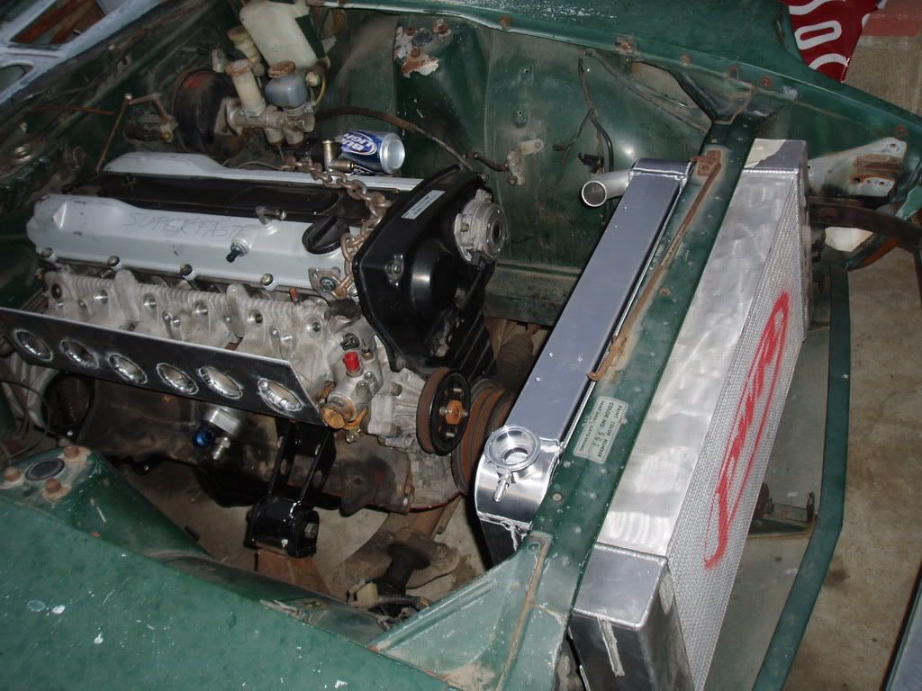

hammeredscout Posted December 26, 2008 Author Share Posted December 26, 2008 Oil filter relocation plate is from Earl's performance and it replaces the factory bulky oil water cooler fitting. From the plate you run hoses to oil cooler and filter. I'll get pics of the rest later. Quote Link to comment Share on other sites More sharing options...

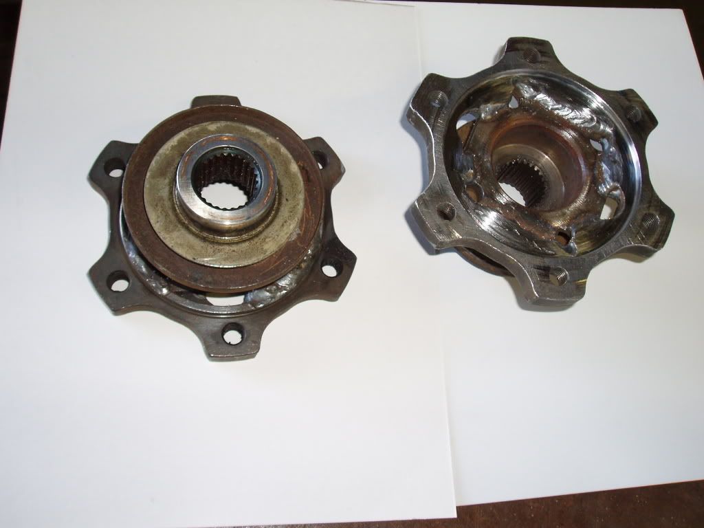

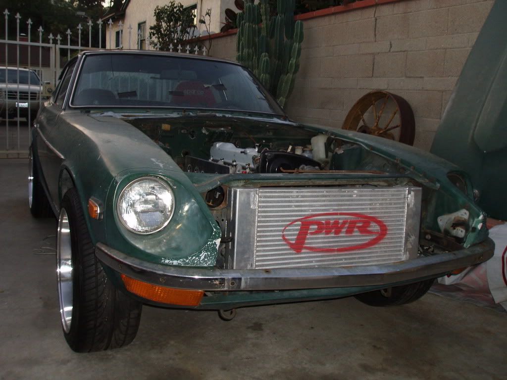

hammeredscout Posted January 23, 2009 Author Share Posted January 23, 2009 Haven't worked on the Z much but did pick up some parts. Got 17X8.5 Wheels Got an Intercooler and Aluminum radiator. Also made some hub adapters for the Q45 R200 swap. That's it's for now. Quote Link to comment Share on other sites More sharing options...

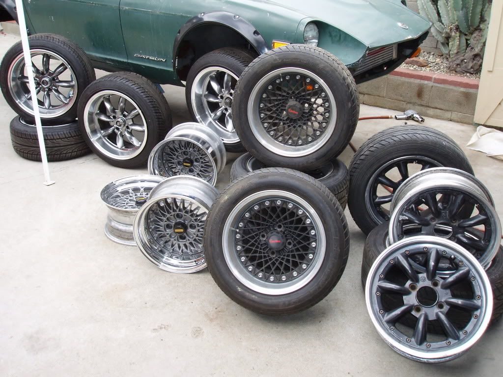

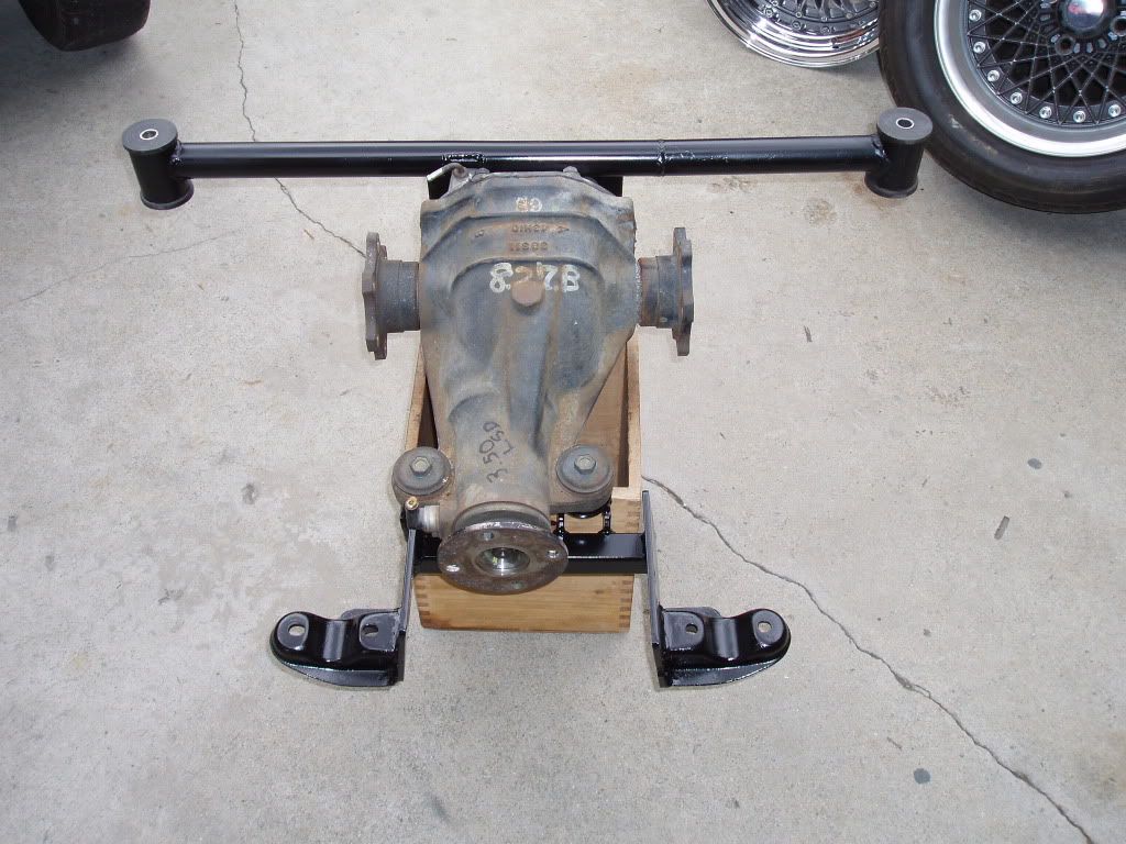

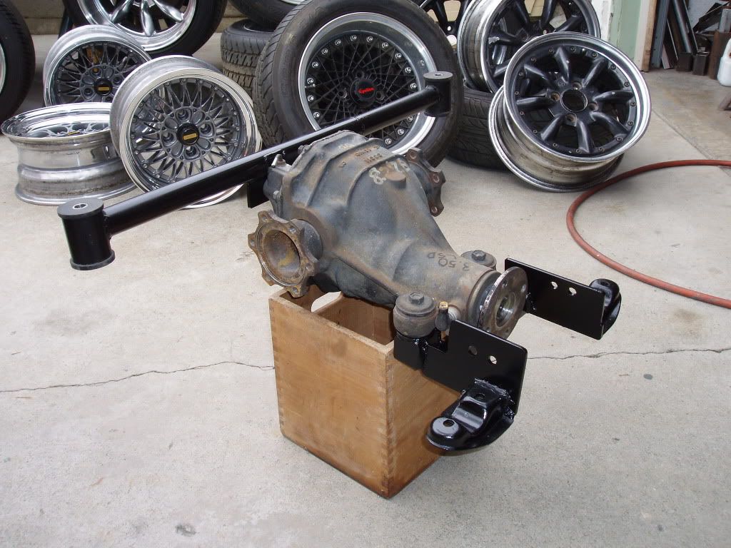

hammeredscout Posted June 12, 2009 Author Share Posted June 12, 2009 Haven't made much progress but here's a couple pics of rims I've accumulated Also finished the Q45 mounts Quote Link to comment Share on other sites More sharing options...
