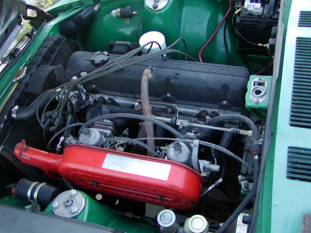

KenshinX Posted July 24, 2008 Share Posted July 24, 2008 Here's my 260z it was converted to SU's years ago. I suggest you check over at classiczcars.com they have more advice with carbs over there search over there I'm sure you will find 99% of your answers. Quote Link to comment Share on other sites More sharing options...

COmputoman Posted July 24, 2008 Share Posted July 24, 2008 There are 3 lines on my fuel rail. .one line with fuel going through it. one line is not being used. The other one Feeds back to my fuel tank I think. I also do not have my vacume lines hooked up. Looks like kenshin just jumped his. (Is this normal? Do these usualy hook up to the vacume advance on your dizzy?) Quote Link to comment Share on other sites More sharing options...
KenshinX Posted July 25, 2008 Share Posted July 25, 2008 Ooops yea those are the old pics I have to upload the new one after it was taken to tidewater Z. Yea the PO had the car "jumped" so it could run to sell it. Sorry. Quote Link to comment Share on other sites More sharing options...
