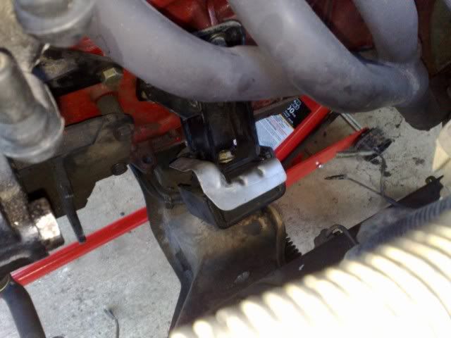

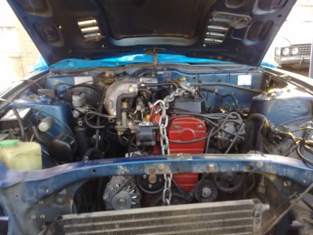

tonycharger72 Posted November 26, 2008 Author Share Posted November 26, 2008 Sorry, this took me ages to get some pics!!! Enjoy!!! & Engine Mounts Quote Link to comment Share on other sites More sharing options...
tonycharger72 Posted November 26, 2008 Author Share Posted November 26, 2008 "I have RB engine mounts, I think they would work in the S30 with a bit of work too and they're quite solid." Careless, Depends what RB mounts you have? R31, R33 Skyline and VL Commodore absolutely don't allow you to bolt an RB engine into a S30! I spend a fun, fun day trying all of them !!! even intermixing them with no joy!!! However, apparently RB20 earlier R32 engine mounts will allow you to slap an RB engine into an S30 - with the stock gearbox crossmember and drive shaft - but I didnt have any to trial to see if this is true! Quote Link to comment Share on other sites More sharing options...

tonycharger72 Posted November 28, 2008 Author Share Posted November 28, 2008 tony, there is a quote button that you could use, and it shows what is being quoted when you're writing your reply. you could remove any text you would like not to be shown from the quote. YAY !!! Thanks for that, was wondering how it was done!!! Does the S14 crossmember bolt into the S30? Even if it did all the suspension components wouldnt work out me thinks............ If you are looking at a cheap easy way to slap an RB into a Z, go to www.rodshop.com.au and purchase a set of their Z-RB engine mounts, think they were around $150AUD or so, which at the moment is about 30 US cents !!! they do push the engine back a bit though - depending on what gearbox you are using (skinny RB20) you can just offset your original Z gearbox crossmember (Fat RB25) cut out the original mounts and throw in some new ones, I will get pics of both for you mate! I should also have pics of the Rodshop mounts, but they really dont look a lot different from the original VL/R31 Skyline Engine Mounts!!! There is a fellow in QLD, Australia who said he put the entire front and rear subframes from an S14 into an S130 and it was more or less a straight bolt in - if I had the S130 I would be doing that for sure!!! Quote Link to comment Share on other sites More sharing options...
