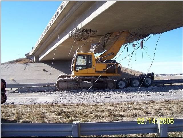

A Backhoe weighing 8 tons is on top of a flatbed trailer and heading east on Interstate 70 near Hays, Kansas. The extended shovel arm is made of hardened refined steel and the approaching overpass is made of commercial-grade concrete, reinforced with 1 1/2 inch steel rebar spaced at 6 inch intervals in a criss-cross pattern layered at 1 foot vertical spacing.
Solve: When the shovel arm hits the overpass, how fast do you have to be going to slice the bridge in half?? (Assume no effect for headwind and no braking by the driver...) Extra Credit: Solve for the time and distance required for the entire rig to come to a complete stop after hitting the overpass at the speed calculated above. Yes, you can neglect friction.

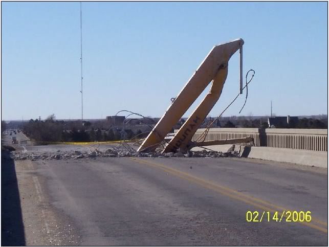

It looks wierd, neither side of the bridge has a full slice (or entrance) that the arm would have cut into the bridge. Unless, the arm was low, then they raised it up post-F-up?
no, it's a case of leaverage, looking at it, the arm was low, but hit the bridge below the side fence, you stick something into a 90* corner while running past and the leaverage means it will stick in the corner. In this case the body of the excavator has a hell of a lot of inertia and caused the arm to punch in, and since the arm stowed would form a trangle side and friction/drag pulled it up, that punched it up through the road base, you can see where the bucket slammed into the underside and rebounded in the next picture.
An interesting illustration of leverage and inertia :D
Ps: as to the strength of the material making up a excavator arm, they're typically a buttressed "I" section with side plates covering the open sides of the "I" beam. The 17 ton Samsung the local contractors had was made from Bisalloy plating between 26mm and 15mm. this is the same plating as is used on gun ranges as steel targets in 10 and 12mm thicknesses. The photo resizing screwed up and pixellated the engine bay door writing in the pic, but it look like it might be saying 220, which would make that a 22 tonner. so if it has thick plating making up the arm, of thicknesses 2 to 3 times the thickness of something which will survive years of being smashed with bullets, then I'm not surprised it bashed the bridge up :D
