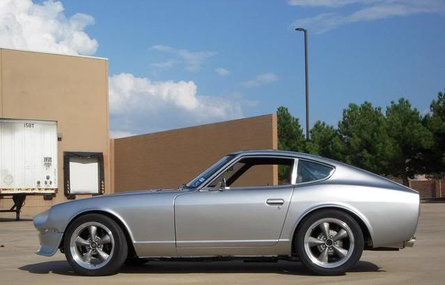

You can see in this old picture that it fits nicely.
I have a 5x8x14 on my car. Its magnflow muffler with a center 3" in/center out with a 4 inch tip.
Here's a pic.
You can kind of see where the muffler ends right at the back of the tire.

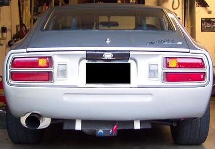

And here is one from the rear...
I can take a better picture if you want. Thats the best I have right now on the computer.
