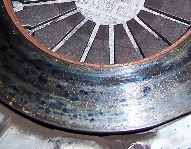

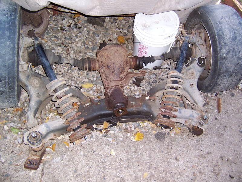

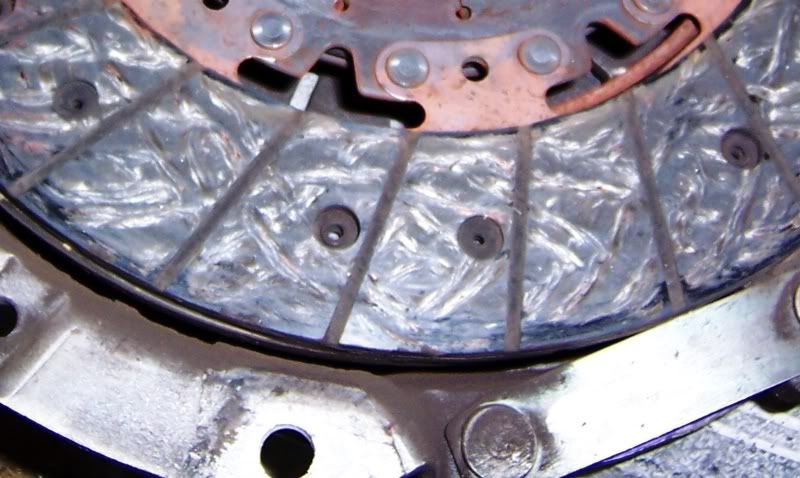

Old Z Guy Posted November 22, 2008 Author Share Posted November 22, 2008 Yep^^ He did not mention that the na was a 2+2. Thank you all for the advice. I am learning as I go on the project and appreciate your help. The N/A is a 2 seater. Below is the clutch I took out of the 82 Turbo donor car that I am using in my 1980 project body. Does this look like the original clutch with 100,000 miles on it? P.S. here is the rear end restoration before and after. Quote Link to comment Share on other sites More sharing options...
blue72 Posted November 22, 2008 Share Posted November 22, 2008 Seeing as the clutch pressure plate says "Made in England", I'm going to go out on a limb and assume that it didn't come out of a Japanese automobile factory that way. Quote Link to comment Share on other sites More sharing options...
woldson Posted November 23, 2008 Share Posted November 23, 2008 Heehee, nice eyes! Quote Link to comment Share on other sites More sharing options...
