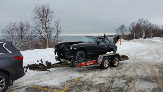

Mike280z Posted January 21, 2016 Share Posted January 21, 2016 How about interchangeable parts between different z models. For example I have a 280z shell, no motor,no diff, no driveshaft, no gas tank... I have the front suspension axles and whatnot. I wanted to know of I can take everything I need to drive out of a early 260 2+2 besides the driveshaft since it's longer? I ask this because where I'm from there really isn't many datsuns at all and I don't have enough for my Rb swap atm. Quote Link to comment Share on other sites More sharing options...
