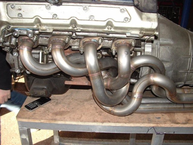

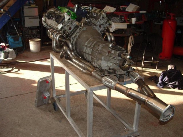

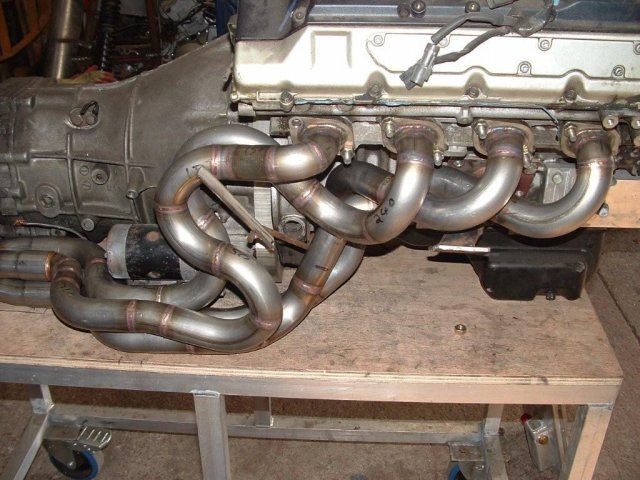

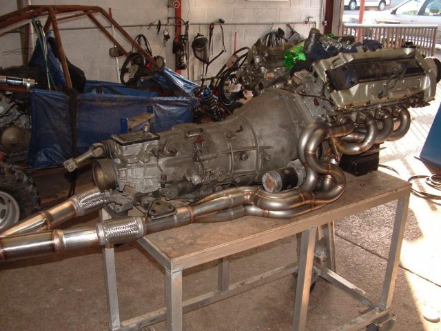

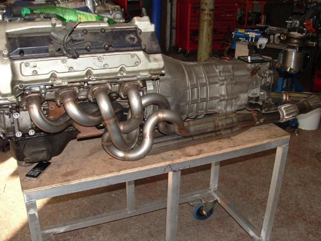

John Dixon Posted November 24, 2008 Share Posted November 24, 2008 Thought I'd put some pics up now it's all finished. All done by Leon at Alunox exhausts in Wrexham, UK. Superb job as always! Manifolds: Quote Link to comment Share on other sites More sharing options...

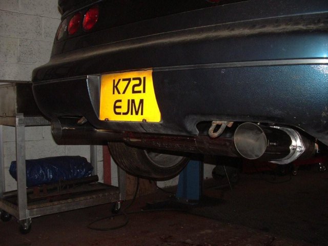

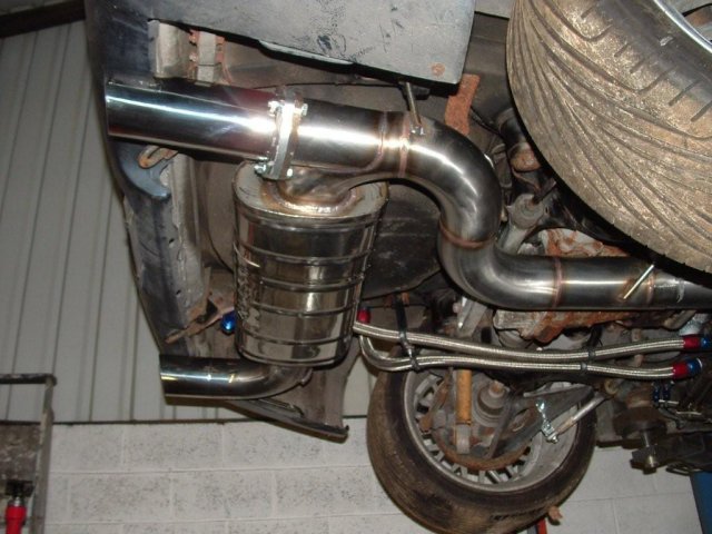

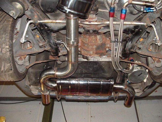

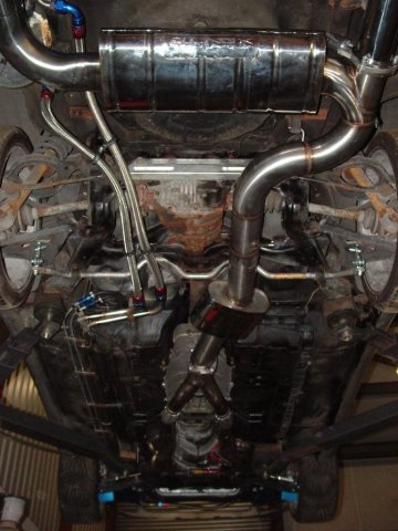

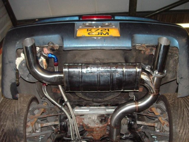

John Dixon Posted November 24, 2008 Author Share Posted November 24, 2008 System: Quote Link to comment Share on other sites More sharing options...

Pyro Posted November 24, 2008 Share Posted November 24, 2008 John Dixon said: Cheers all, will get another vid, this time with the exhaust fitted and see how it sounds Wow! those headers look like a lot of work! How long are those header tubes? What was the reason for such a long tube? Trying to make low speed torque? Quote Link to comment Share on other sites More sharing options...
John Dixon Posted November 24, 2008 Author Share Posted November 24, 2008 They're about 2 weeks work believe it or not. He's done an awesome job, so much stuff thay had to be wrapped around and dodge! They're 41mm ID, 1000mm long, tuned for 5000-5500rpm peak torque. Quote Link to comment Share on other sites More sharing options...

John Dixon Posted November 24, 2008 Author Share Posted November 24, 2008 BRAAP said: INCREDIBLE! GORGEOUS! INSPIRATIONAL! Lol, thanks, that's quite a compliment from you! All I did was the specs though, the work is all Leon's. Don't know how he manages to design the tubes to get the lengths equal - as much skill in that as the actual fabrication. Quote Link to comment Share on other sites More sharing options...
