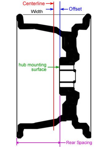

FRONT = 17x10 5 5/8" backspace, which would be a +16 offset (roughly)
REAR = 17x12 5 3/8" backspace, which yields a -16 offset (roughly)
I "think" I have the calculations correct. Please correct me if I'm wrong.
So - I need to find a set of 17's in a 4x114.3 bolt offset to put race rubber on.
ANY ideas??
Also - when measuring wheel width, does one measure from outer lip to inner lip (extreme most portions of the wheel) or from where the bead seats? Haven't been able to figure that one out yet. If so - my measurements above will differ.

OK - help me out here guys. If I'm measuring from bead seat to bead seat (which I can't do b/c the tires are mounted currently) to calculate width, then would it be safe to say I'd subtract an inch from the overall wheel width? (1/2" per bead lip) to surmise the proper wheel width?
That being the case (if true), that would make my wheels 17x9 up front and 17x11 out back. Backspace is still measured from the mounting pad to the innermost lip, so it hasn't changed, but what HAS changed is my offset. Help me out and make sure my calculations are correct.
Offset = backspace minus the centerline of wheel.
Front = 9", so 4.5" would be the centerline. Backspace of 5.625". So 5.625-4.5= 1.125" correct? Multiply by 25.4 to get mm = 28.575 offset.
Rear = 11", 5.5" is centerline, backspace 5.375", so 5.5-5.375=0.125" or 3.175 offset.
So, since my fronts are wider on the inside, that makes the offset negative - correct? That would make my rears a positive offset, yes??

Looks like you got it. It is a basic calculation and the relationship does not change. You really only need to give the wheel maker either the offset and width or the backspacing and the width (besides the diameter of course). They will take care of the rest.
When you are using a backspace measurement to find your offset you need to use the overall width of the wheel for the calculation.
17x9 = 10" overall so
centerline = 5.0= 127mm
(I work in Millimeters)
BS= 142.875
BS-CL= 142.875-127= 15.875 offset on a 9" wheel
Rear
BS-CL= 136.525-152.4= -15.875 on an 11" wheel
If you need a detailed explanation PM me and I call you.
Roy
