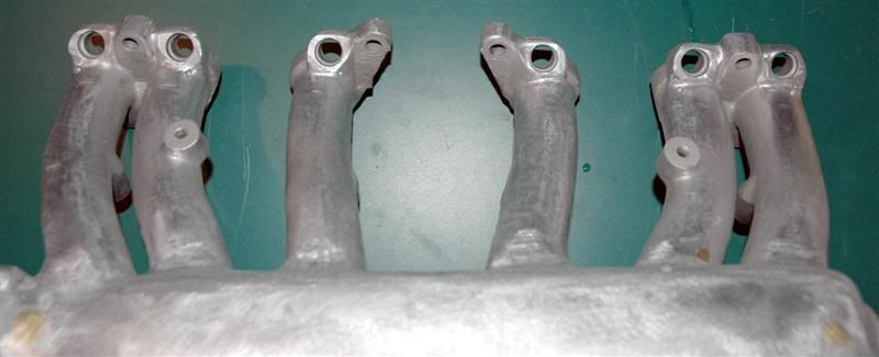

Here are some of our custom factory L-6 intakes I’ve done over the years.
If they are to be painted, all the large holes are plugged with brass pipe plugs. All small divots are then filled in with JB weld. Final shaping, sanding, then painted. My first intake was done that way back in 1989, as well as my last for the Race car a couple years back.
For the polished or ceramic coated versions, aluminum pugs are cut up and welded in the larger holes, divots filled in as well. I farm out the welding as I am not a welder.
Here is one in process;
Finished products;
First intake I did:
This is good a friend, member here and officer in NWZ club. WAS an EGR intake, machined off the EGR plenum from the back plugging the individual transfer ports in the runners themselves. This is a bone stock ’75 L-28, factory EFI, everything function as stock, other not having the air flow regulator, (initial idle speed is set higher than normal to maintain idle when cold.)
Another good friend for his really nice yellow S-130, ceramic coated N-42 intake modified for modern O-rind style injectors;
Next to unmodified manifold;
My race car;
In process, fuel rail attached, still needs some work;
Fuel rail mounts of race car mani;
Vacuum ports of race manifold;
Another N-42 intake, for stock throttle actuation and stock injectors;
