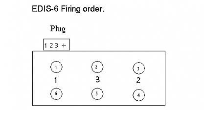

ZXT_bean Posted February 2, 2009 Author Share Posted February 2, 2009 now as for the firing order.. i think i got it right.. cly 1/6-2/5-3/4... ive made this drawing to help understand. if it is wrong please lmk! im using the ford coil pack. Quote Link to comment Share on other sites More sharing options...
Administrators BRAAP Posted February 2, 2009 Administrators Share Posted February 2, 2009 twisted280z said: now as for the firing order.. i think i got it right.. cly 1/6-2/5-3/4... ive made this drawing to help understand. if it is wrong please lmk! im using the ford coil pack. Correct. Cylinders 1-6 paired to the first firing coil; Cylinders 2-5 paired on the next firing coil; Cylinders 3-4 paired up on the last firing coil. Quote Link to comment Share on other sites More sharing options...
ZXT_bean Posted February 2, 2009 Author Share Posted February 2, 2009 BRAAP said: Correct. Cylinders 1-6 paired to the first firing coil; Cylinders 2-5 paired on the next firing coil; Cylinders 3-4 paired up on the last firing coil. awesome! now all im waiting on is i have find a 240sx TB... and I have to find the Z linkage peice from a stock TB. order some gaskets, and I should be ready to turn the key! Quote Link to comment Share on other sites More sharing options...
