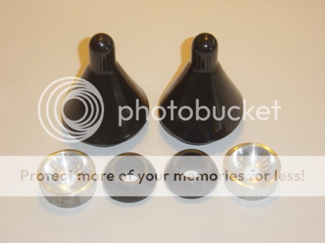

giorgio61 Posted February 25, 2009 Author Share Posted February 25, 2009 I really have no idea as to the manufacturer here is a pic maybe it looks like yours? Thanks in advance. One more question, did you use a polyutrethane bushing or the oem rubber? I've read of PU bushings breaking rods at the shoulder before the threads even using the T-C kit. George Quote Link to comment Share on other sites More sharing options...
YellowFever Posted February 25, 2009 Share Posted February 25, 2009 I really have no idea as to the manufacturer here is a pic maybe it looks like yours? Thanks in advance. One more question, did you use a polyutrethane bushing or the oem rubber? I've read of PU bushings breaking rods at the shoulder before the threads even using the T-C kit. George My t-c kit looked just like that. The span across the measuring device is 57.5mm (2.263773 inches according to my conversion program). Can't remember what bushing I used at the rear 'cause I'm old and can't remember anything that I did 2 years ago. Quote Link to comment Share on other sites More sharing options...
