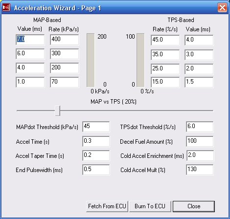

cygnusx1 Posted May 3, 2009 Share Posted May 3, 2009 Mike, most of your AFR spikes are centered around throttle position moves. This is going to get better as you fine tune your AE settings. I do see a tach spike at 1302, 1324, and 1339sec. Start inching in AE enrichments, based on TPS, MAP, or mixed. I run mixed, 80/20 with MAP dominant. Get into the tuning screen for AE and move your pedal around and watch the AE bar, to get a feel for TPS threshold. Then set your AE pulswitdhs low for now. Bring them in slowly. I will post mine if you want a reference. BTW Now is a great time to start bringing your log files and msq files into MegaLogViewer and running VEanalyzer. After three iterations of VEanalyzer, the car should be running MUCH better providing you have a good AFR table. I included mine here. Quote Link to comment Share on other sites More sharing options...

cygnusx1 Posted May 4, 2009 Share Posted May 4, 2009 Some people recommend tuning with the AE off. I did it with the AE on. It's just another variable to juggle. You can get the VE table real close with AE off or on, using VEanalyzer. Your call. I got the car driveable "by ear" then adjusted the AE "by ear". I got it driving well while watching my AFR's and manually tuning after the drive. When I thought it was running well enough, I began VEanalyzer. That's when things really got better. I went back and forth for a long time...as a matter of fact I am still tuning. It never ends. I recently went closed loop with Autotune (MSII) and the car is self-correcting, as I drive, to match the actual AFR's to my AFR table! Right now it drives better than my factory WRX, as far as response, smoothness, power delivery, and I am getting 22mpg in mixed driving. Quote Link to comment Share on other sites More sharing options...
