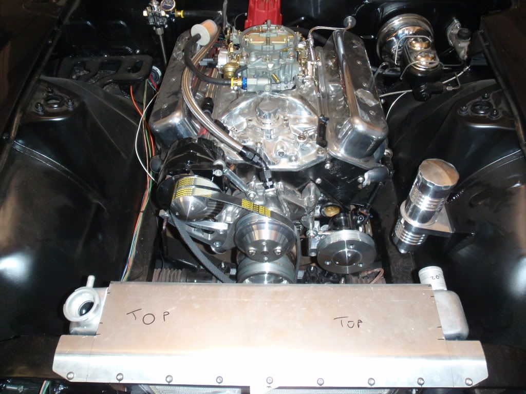

sweetride2go Posted May 2, 2009 Share Posted May 2, 2009 Look in Summit Racing, I know they have universal powersteering pump mounts that mount low on the block, utulizing the ooold two bolt motor mounts holes on the front corners of the block. Here is how mine sets. I'm using a GM type II pump (lower right) and a remote resivor(just to the right of the pump). I don't remember, but Summit or Zoops makes the bracket. I havn't plumbed them in yet however... Hope that helps... Cheers Ryan~ Quote Link to comment Share on other sites More sharing options...
JDTIPPIT Posted May 4, 2009 Author Share Posted May 4, 2009 Wow! That motor looks great. Thanks for the help sweet ride. Quote Link to comment Share on other sites More sharing options...
Guest Downlow Posted May 5, 2009 Share Posted May 5, 2009 That's one clean Quadrajet, Sweetride! I'm waiting on one from SMI for a warmed over ZZ4, I'm interested to see how it will perform compared to the other carbs. Quote Link to comment Share on other sites More sharing options...

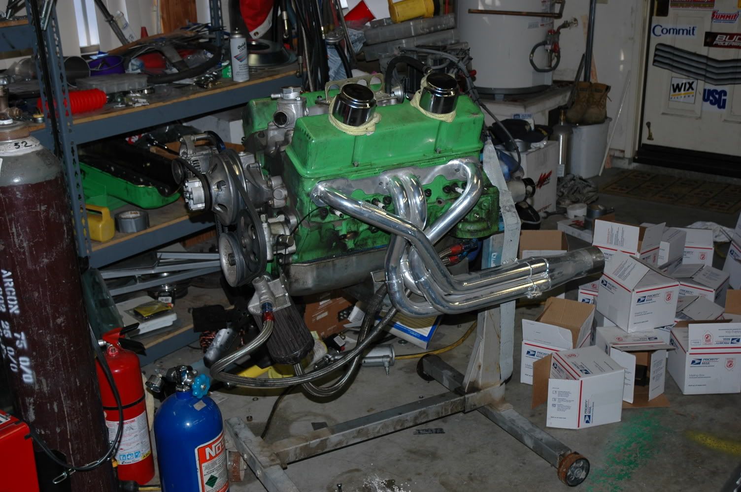

hoov100 Posted May 6, 2009 Share Posted May 6, 2009 heres a crappy pic of me and a friends auto-x car's power steering setup its on the right side of the block right above the oil filter. Quote Link to comment Share on other sites More sharing options...
