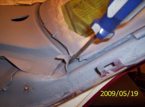

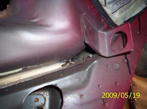

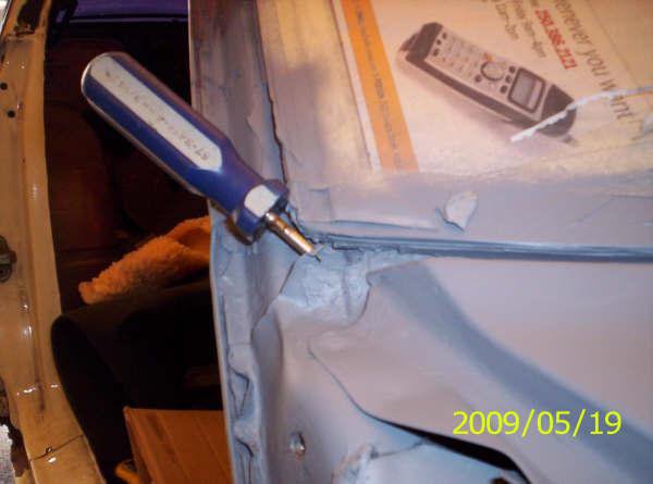

islanddozer Posted May 19, 2009 Share Posted May 19, 2009 I am rebuilding my 1980 and am at the pillars right now. I have found a flaw in the design arround the pillars and vallance. I have posted pics below. There is a seam that the valance covers that leads right to the kick panel on both sides. I slid a screwdriver down the hole to show where the leak is.The last pic is from the inside looking at the corner. There isn't mcuh room but you can get a can with a straw of rust proofing in there. I pealed back the metal, took a putty knife under the windsheild and cut away adhesive back to where I couldn't feel any rust underneath, wire brushed, took a pick and cleaned away factory seam seal (what were they thinking when they used this porous stuff), rust proof area, self-etch primer, and proform pf 214 firm and flex rubber sealant. If you own a zx you really should look at yours. I live in a rainforrest so any leak is 10 fold here. I would suggest you grab those clips offered to you and cut the old off. Use 2 sided pro tape for moldings to install. easy. Good luck Quote Link to comment Share on other sites More sharing options...
