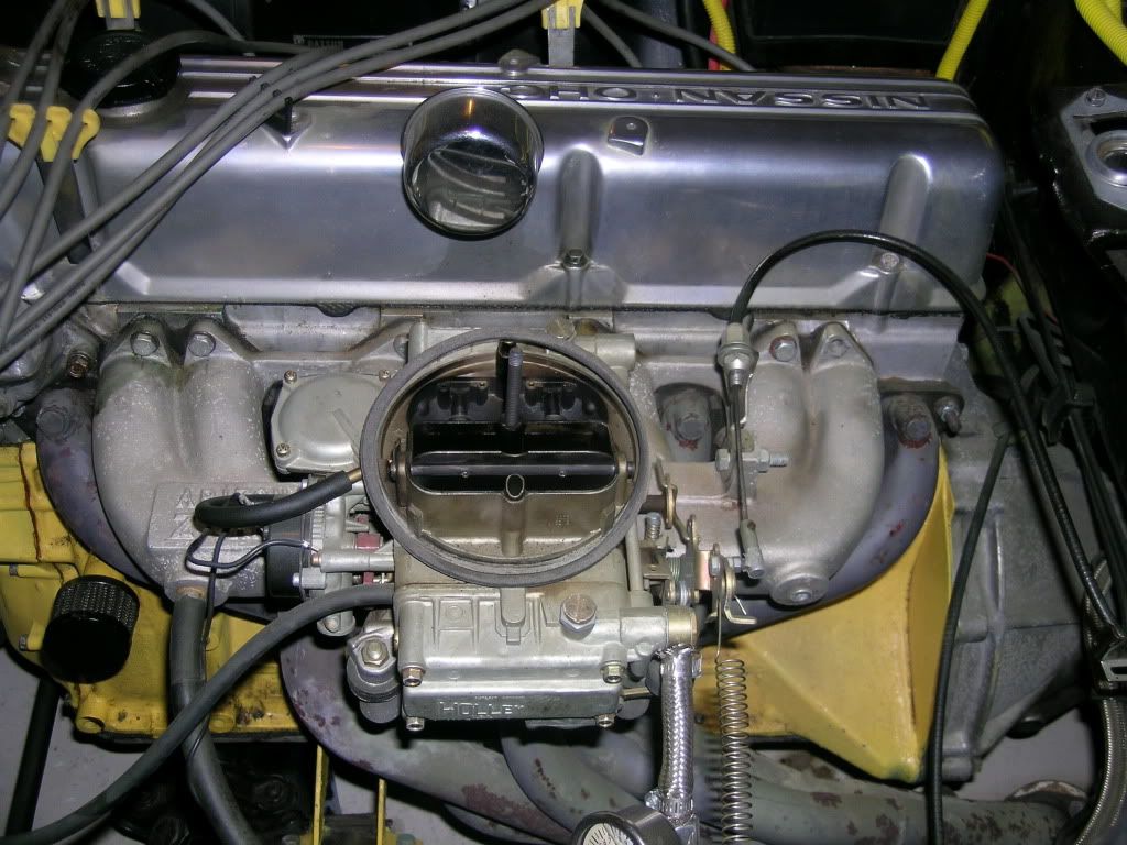

My current 4barrel:

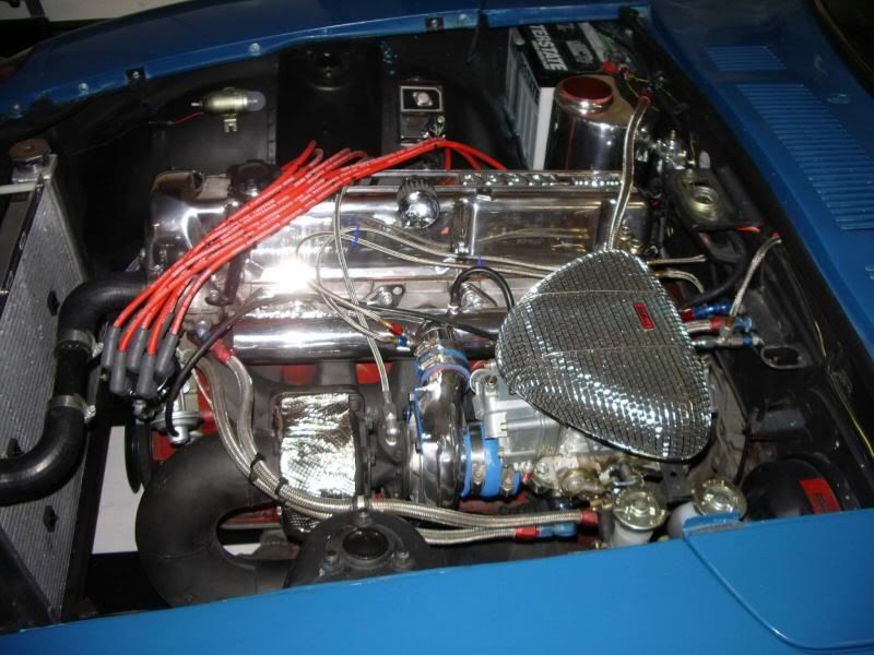

Old school Turbo Tom kit:
turbotomscar2.jpg?t=1243731217
The problem is not boiling the fuel in the carb since the major heat is at the other end of the turbo. Freezing it can be the issue on cold days.
EFI would be easier given today's technology.
