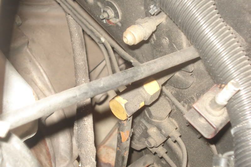

ok. Just got done poking around the interior of the Z and I think everything is there. I turned on the AC and the blower was working and putting out a decent amount of air. Anyone know of a newer more effecient blower that I can swap in its place? So far the only thing I can tell that is missing is the compressor, condensor/fan, dryer and some hoses. Is the expansion valve located under the dash or in the engine compartment? Looks like one of the lines are also there and another connector coming out of the firewall is there as well. I took some pics below:
The expansion valve is mounted right in front of the evaporator, upper right hand side. I just charge my Z's system up yesterday using the 30 year old evap and expansion valve and it works great. Even wired in a pressure switch to kick my electric radiator fan on when the condenser starts getting warm.
Edit: A note on the blower motor: there is a noticeable difference when you reseal all your ducting with new foam strips and make sure everything is hooked up correctly. Mine is a little squeaky, I might look into a replacement.

your evap system looks complete w/ the exp valve. from the pics it looks nice and clean.. but one ck you may want to do is swab the bottom of the plastic housing to ck for oily residue that would show signs of a leak @ one point in time.
if clean , i would say it is good to go, .. the hose that is missing on your fire wall is the one that runs off of the dryer unit. , not a big deal , you can get those lines made custom.. I don't know if you have a 4 seasons radiator retail shop there in san antone, but they made my lines here in h-town.

Which housing do I need to swab to check for oil residue?
