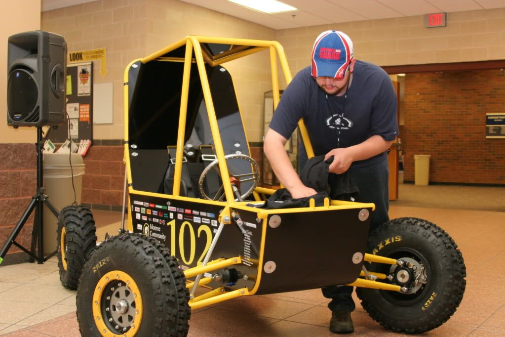

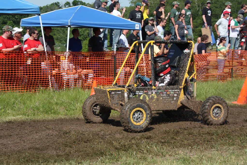

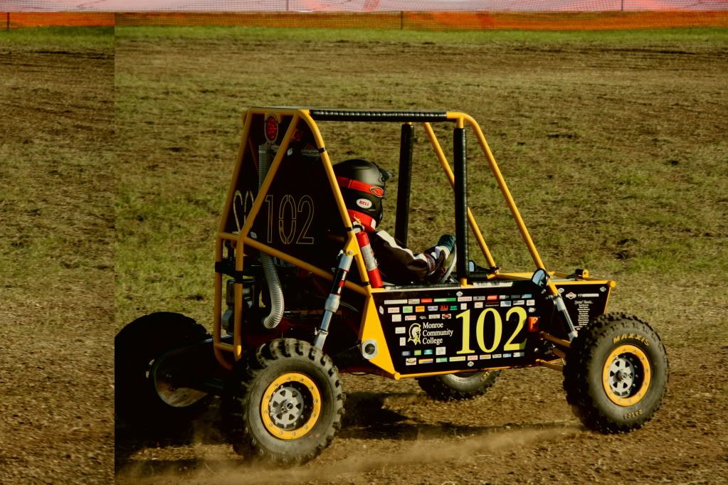

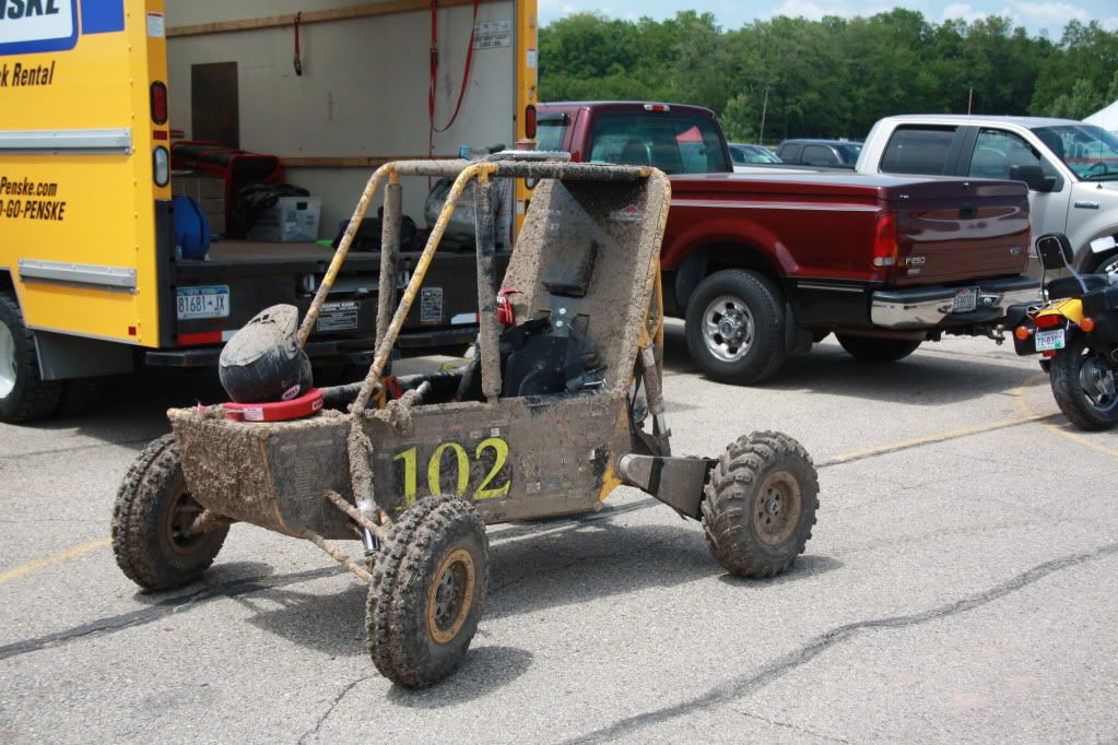

letitsnow Posted June 18, 2009 Share Posted June 18, 2009 Was anybody else at the Wisconsin competition this year? I was there on the MCC team, car 102. I'm wondering if I inadvertently talked to any other hybrid z'ers while searching for various tools or parts we didn't have. We had the black and yellow swing arm car. Here are a few pictures, I'm waiting for our adviser to upload the rest. And one of the car clean before we had everything together to mount the shocks. Quote Link to comment Share on other sites More sharing options...

letitsnow Posted June 18, 2009 Author Share Posted June 18, 2009 We're required to run an untouched 10hp briggs, we can use any drivetrain after it though. It adds another thing to design around, being an engineering competition. We used a jr dragster cvt with a single 12t/60t chain drive, we ended up with one of the faster accelerating cars out there. The swingarm design worked out very very well, it took a little more driving than the IRS cars, but we made it work. I do have to say that I'm thankful for every single piece of roll bar padding and safety harness/cushion, we had 11" of travel at each wheel, but you still get thrown around a lot. Especially if you come up short on a double. It is still really fun to drive, the race track was a relatively mild motocross track with a few obstical course style sections, like a rock section and some telephone poles layed down around a corner. Ours has room for a 22hp vtwin in the back though. Quote Link to comment Share on other sites More sharing options...
