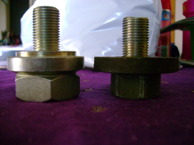

burntread Posted June 4, 2010 Share Posted June 4, 2010 Hey Phred, What was the length of the harmonic balancer bolt? 16mm thread, 1.5 pitch, ??? length? If you know, it would be greatly appreciated! -Burntread Quote Link to comment Share on other sites More sharing options...
HowlerMonkey Posted June 4, 2010 Share Posted June 4, 2010 I've seen two different crank pulley bolt lengths. Just though I'd throw that in. Quote Link to comment Share on other sites More sharing options...
ozconnection Posted June 5, 2010 Share Posted June 5, 2010 Here they are. Quote Link to comment Share on other sites More sharing options...
