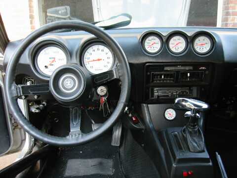

I finally got around to installing some autometer gauges into the datsun, and what a field day it's been. I thought I'd be able to adapt something for the tach and speedo, but givin my time I just ended up doing the ol' silicone trick. It holds a lot more solid than I thought it would.
Has anyone installed the smaller 2 5/8" gauges into later Zs? I went into the car expecting to do it like blkmgk's but behold it's different. I have a 75 and it doesn't really bolt in to anything, there's just a cradle. Maybe I'll take some pics later. What have you guys done for these gauges?
In my 77 Z I replaced the clock w/ a 2 5/8 boost gauge by just using the clock housing and drilling a couple of holes in it for the boost gauge outlet and light. Since I used the stock housing, it bolted right back in where it came from. Mike
I replaced the three gauges in the stock Datsun pod with Autometer 2 5/8 gauges. It's actually quite easy, once you can get to everything.
The trick I found, was to use as much of the OEM mounting hardware as possible. The Autometer gagues were not as deep as the Datsun ones, so I had to "wedge" some pieces of cardboard between the new gauges and the mounting strap in back. I suppose you could use rubber, or plain paper if you wanted. Be creative, that's what we are all about.

2.5 PSI of fuel pressure (top picture only) and Z-E-R-O oil pressure icon_eek.gif
Actually, the stupid isolator for the fuel pressure gauges needs to be bled every year. As you can clearly see, I never got around to it this summer. Also, I think it's pretty cheap of autometer to not put some sort of power diode in their tachs to get the needle to rest a zero when the ignition is off.

I did this swap as well, I used a piece of styrofoam insulation. I used a knife to cut it to the desired shape and made a spacer from it. Then I wrapped them with electrical tape to keep any flakes from getting into the vents. It was easy, cheap, and turned out really good! icon_smile.gif
Oh, I also had to poke a hole through the center to make way for the oil line/capillary tubes.
