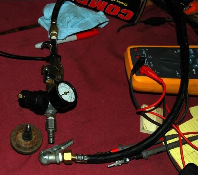

jt1 Posted August 8, 2009 Share Posted August 8, 2009 FWIW, like Ron, I never bench bleed a master. I put it on the car, bleed it a couple of times, the bleed the rest of the car, and repeat the process. I've found bench bleeding to be a waste of time, but a lot of people think it's a good thing, so YMMV. The best thing I've done is JB weld a quick coupler into an old master cyl. cap. Then I set the regulator on my compressor to about 10psi, hook it to the master, and bleed away. It works great, forces air out better than pumping, and you can do it by yourself. Somewhere between 15 and 20 psi you will blow the cap off the master and blow brake fluid everywhere, so stick with about 10 psi. You may have a little more pedal travel with the discs than with the old drums. The physics are that you have to move a little more fluid for the bigger pistons, which necessitates more MC travel, which means more pedal travel. This is where the ZX mc helps outs. When I went from 1 3/8 pistons to 1 3/4 pistons on the front of my car, I wound up with more pedal travel, but better brakes. This isn't a bad thing since it makes modulation of the brakes easier. jt Quote Link to comment Share on other sites More sharing options...
Administrators BRAAP Posted August 8, 2009 Administrators Share Posted August 8, 2009 My pressure bleeder is similar, I use my bubba-remote-regulator apparatus. I use a thread-in Schrader valve in an old M/A cap, (gotta be careful most have vent hole i the perimeter of the rubber seal that will allow the fluid to pump out). I typically keep it between 7-8 PSI. As jt1 said, any more than 15-20 is a huge paint eating mess looking for an engine bay to take place in. When I did the Z-32, It was a little more elaborate. Pressurizing a gallon container filled 1/2-3/4 full of brake fluid that fed the Z-32 M/C. Modified an extra M/C cap to connect the gallon reservoir to the M/C reservoir. Set it at 7 PSI, go to each wheel and let it bleed... For the Z-32, the ABS actuator is behind the passenger seat in the cabin, above the rear suspension. The ABS has its own bleeder valves which need to be bled as well. Front brake lines ran from the M/C to behind the a passenger seat to the ABS, then 2 separate lines back up front to each wheel! LOTS of fluid in a Z-32! Pressure bleeding is the only way to fly with a car like that. Quote Link to comment Share on other sites More sharing options...
