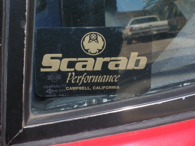

Scarab 155 Posted August 30, 2009 Share Posted August 30, 2009 It would help us help you if you gave us more information on your car. A "Scarab" Z could be anything from a factory VIN car, to a Scarab kit conversion or an older generic name for a V8Z. Since your description of the shift patten of the transmission suggests that it is (at the very least) not a factorey VIN Scarab, what is engine is in your car and do you have pictures of the engine bay ? This will help. Thanks Quote Link to comment Share on other sites More sharing options...

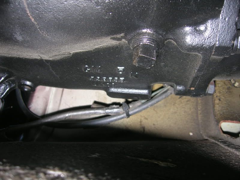

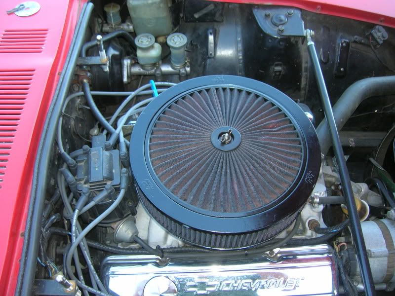

stairs240z Posted August 31, 2009 Author Share Posted August 31, 2009 It looks like a kit, I don't see a vin number, but i have the engine code and some other pics for you guys and gals. Again all help is appreciated. The Engine code This is the best shot I could get...sorry and the rods and such, I don't know if this helps. and some random photos for you. Quote Link to comment Share on other sites More sharing options...
Scarab 155 Posted August 31, 2009 Share Posted August 31, 2009 Great shots -- Here's what I can figure: I think your transmission is a Ford "Top Loader" --4 speed -- but the case and shift pattern match -- how/why it got mated to the Chevy small block is ??? See this link and scroll down to the end http://www.kevinstang.com/fordshift.htm What year , etc. I'm not sure. so ratios are unknown. Your engine block is Corvette/Camero preformance -- should be a 4-bolt main. The car was probably initially converted to V8 with a Scarab Kit - hense the decal on the quarter window. That came with the kits. Looks changed by now - see if you can get a shot of the bellhousing where the clutch fork is.. Scarab used a special bellhousing. Other things to photo -- motor mounts ,headers -- that way I can help ID the rest of what you have. Scarab 155 Quote Link to comment Share on other sites More sharing options...
stairs240z Posted September 1, 2009 Author Share Posted September 1, 2009 I asked my cousin to look at this page and look at the transmission. He said he thought it was a saginaw trans 4 speed. I took a look on the internet and found a drawing of the transmission. It looks close, but what do you guys think. Quote Link to comment Share on other sites More sharing options...
hoov100 Posted September 1, 2009 Share Posted September 1, 2009 looks like an iron case muncie to me. motor looks like an early 70's vette motor. (010 casting number) with HEI. looks like a good solid car that only needs cleaned up. Quote Link to comment Share on other sites More sharing options...
Scarab 155 Posted September 1, 2009 Share Posted September 1, 2009 From the photo of the transmission, I (personally) cannot see any side cover or side cover bolts .. This suggests the access cover is on the top of the transmission. -- That's a Ford. Secondly, the shift pattern you mentioned where Reverse is left and down also suggests a Ford transmission. Saginaws had the Reverse shifter stud near the others but so do Ford Top loaders. All Muncies had a removable side cover as well as Reverse left and up. Best get more photos of the transmission -- can you see the top of the transmission ? Also any and all casting numbers. If you want, PM me and we can see about meeting where I can inspect the car and help ID things. Quote Link to comment Share on other sites More sharing options...
hoov100 Posted September 1, 2009 Share Posted September 1, 2009 I see four side cover bolts, and the GM logo with a part number cast into the case all with the pics he posted, (the shifter linkage is also way wrong and the as for the reverse being left down case doesnt even have any resemblance of a ford or saginaw) instead of left up, that can be changed with either the shifter, linkage or the gears, but his explaining the shift pattern was sketchy. the best thing to do is to get the part number. Its on the passenger side at the top right above the GM casting. take note on this trans that the lever on the side cover for reverse is pointed up, which would mean that reverse would be located left up, while the one in the z is pointed down, which would make it left down. edit: after looking at pics on google, the reverse linkage isnt on the tail shaft, its on the side cover making it a saginaw 4 speed. Quote Link to comment Share on other sites More sharing options...
