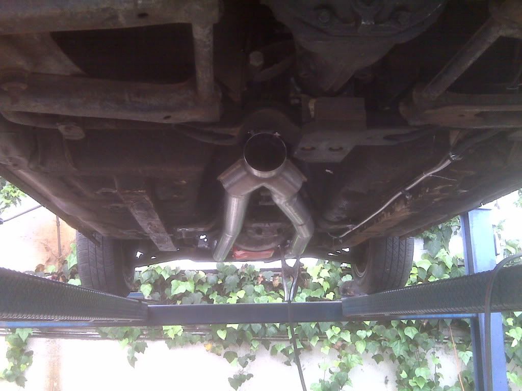

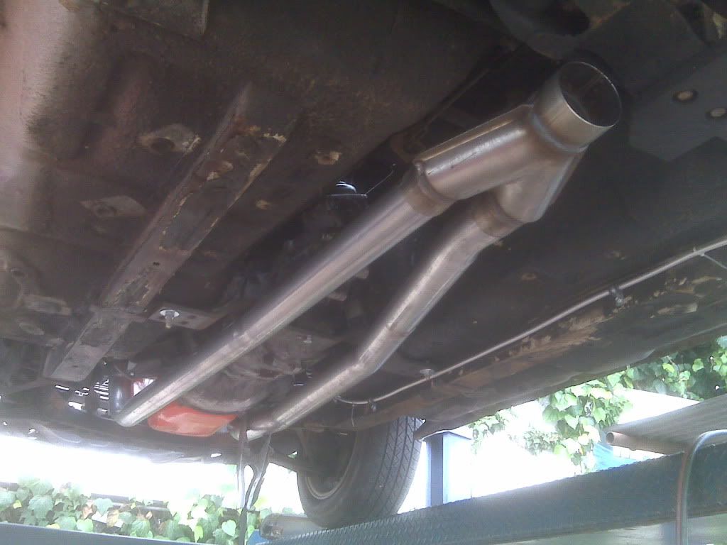

rustorbust Posted August 18, 2009 Share Posted August 18, 2009 This is how i just recently did mine, block huggers, 2.5" to the cheap summit merge to a 3" single..... Quote Link to comment Share on other sites More sharing options...
