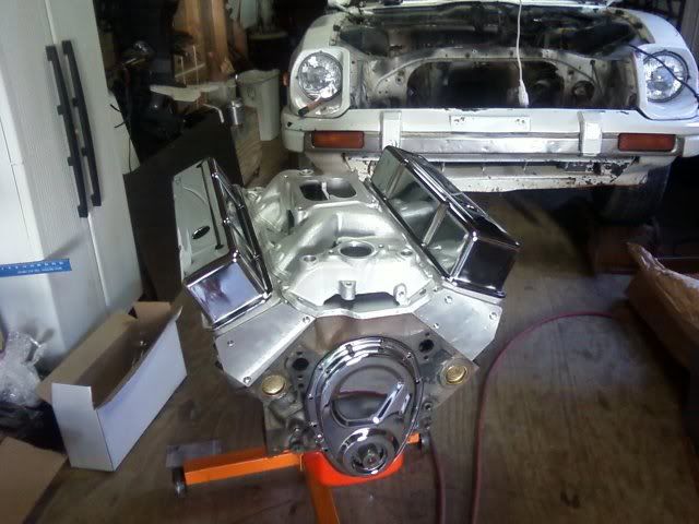

speed Posted August 20, 2009 Share Posted August 20, 2009 (edited) Ok guys, here is the relevant info.. Car is a 1979 280zx. Parts of the floorboards, firewall and both frame rails need to be replaced. Because of the power of the engine going in, I am considering using 4 x 2 x .083 rectangular tubing for the frame rails. Is this over kill? Is it not enough? 3 x 2 x .083 is also available but under the circumstances... when the car is done I don't want to be wondering if it is all going to stay together when I am playing around. This is a serious inquiry as the car is in my shop, the engine is mocked up, and I am looking to get the tubing. Having never attempted anything of this magnitude before, I am cautiously optimistic. All the inspiration a man could ever need is on this site, and there is some remarkable talent here. The way that I work allows me 14 uninterrupted days at home to finish the honey do list and play in the shop. The only limiting factor is finances.(It tends to run out after the first week off). Thanks for any suggestions and any advice that you have learned from your own project that you feel may be helpful. john Edited August 20, 2009 by speed added picture Quote Link to comment Share on other sites More sharing options...
