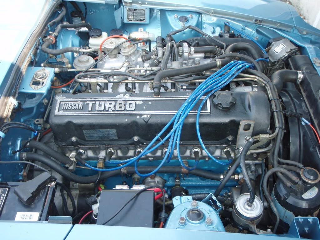

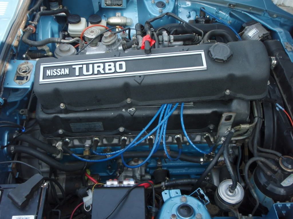

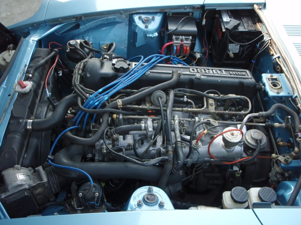

zwilliams Posted October 3, 2009 Share Posted October 3, 2009 (edited) I run the SHO fan and it fits with trimming the shrowed all the way around and cutting down the studs on the water pump.It slides up from the bottom. Here are some pics but they are not really focused on the fan. f Edited October 3, 2009 by zwilliams add info Quote Link to comment Share on other sites More sharing options...
