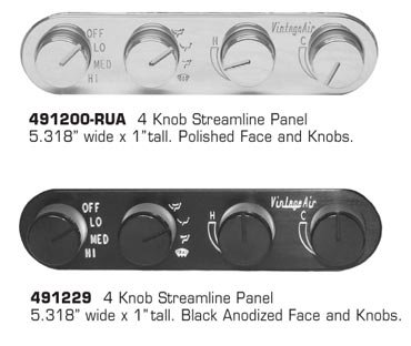

mikeith Posted October 7, 2009 Author Share Posted October 7, 2009 i though about vintage air but i want a more modern simple look w/ the hvac controls... kinda like this Quote Link to comment Share on other sites More sharing options...

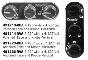

jeff81 Posted October 7, 2009 Share Posted October 7, 2009 I am having a Gen IV installed on my Z. It will be a few months before it get to the issue of connection in the car. The unit can be controled by a relatively small 4 knob setup. Jeff Quote Link to comment Share on other sites More sharing options...
mikeith Posted October 7, 2009 Author Share Posted October 7, 2009 I am having a Gen IV installed on my Z. It will be a few months before it get to the issue of connection in the car. The unit can be controled by a relatively small 4 knob setup. Jeff i like that! last time i looked at vintage air they only had the old looking one... may just go that route. Quote Link to comment Share on other sites More sharing options...
