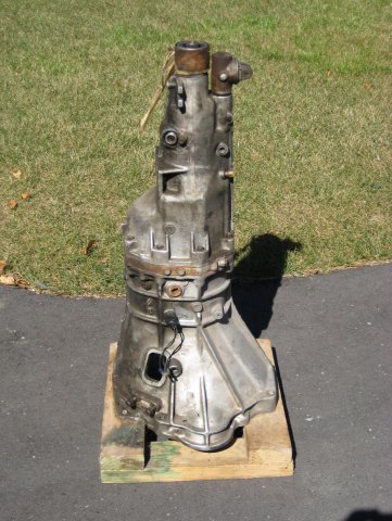

joker72z Posted October 27, 2009 Share Posted October 27, 2009 I tried using the search to find a thread that would assist me in identifying a 5 spd I have been offered but I am stumped. There are no really clear stamping marks that make sense but I will list what I can see. There is a number " 7Y09617 " and another stamping " 45 - 10-18 " and some numbers inside the belhousing. I'll attach a couple of pictures that were provided and will greatly appreciate anyone letting me know which trans it is. Cheers and thanks Chris Quote Link to comment Share on other sites More sharing options...
MAG58 Posted October 27, 2009 Share Posted October 27, 2009 I could be wrong, but from the looks of it, it appears to be the early 280Z five speed, the wide ratio with the relatively short overdrive. Quote Link to comment Share on other sites More sharing options...
m4xwellmurd3r Posted October 27, 2009 Share Posted October 27, 2009 looks like a 280z transmission. I could be wrong though Quote Link to comment Share on other sites More sharing options...
joker72z Posted October 27, 2009 Author Share Posted October 27, 2009 Thanks Bob, I was unsure and before I pay for it, I wanted to confirm this. The early 5 speeds also had the 5th gear share the same fork as reverse didn't it? Any issues with that or should I be looking for a late model trans where they are independant of each other? Once again...thanks Quote Link to comment Share on other sites More sharing options...
Xnke Posted October 27, 2009 Share Posted October 27, 2009 All the FS5W71( or © transmissions have a 5th/reverse shared shift fork. It doesn't seem to be an issue; at least I've never heard of one. Did break a R/5th shift fork one time, in my cousins's 240SX. pain in the butt! Quote Link to comment Share on other sites More sharing options...
