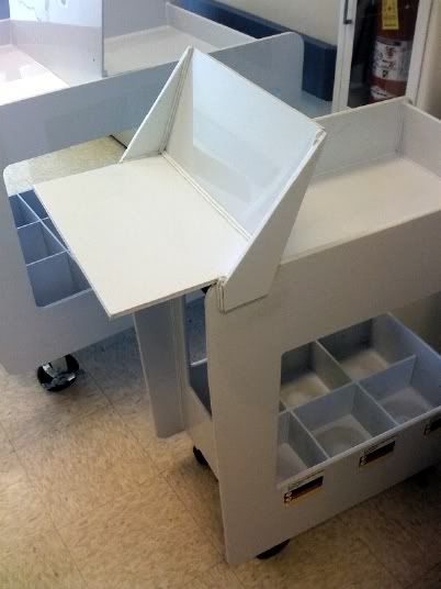

I occasionally weld plastic. What I use is similar to that linked in the first post, but with a rollerized rod feeder/guide (manual) slipped on the end. I've only used it on PVC, CPVC, and Polypro.
Depending on weld orientation and quality, it can be reasonably strong.
Built a laptop stand on an existing poly cart a couple weeks ago for a customer...
