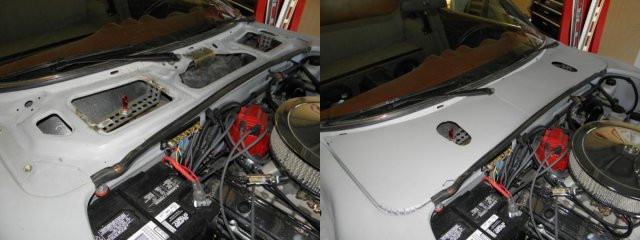

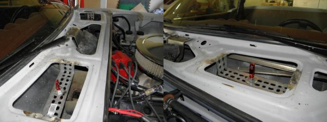

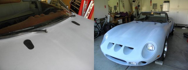

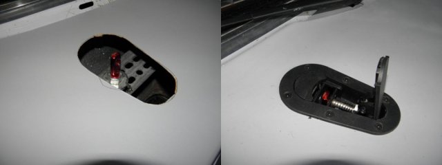

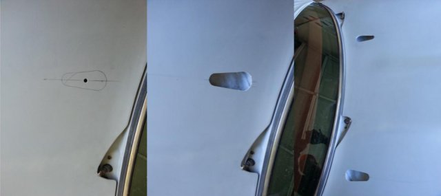

Fauxre Posted April 23, 2013 Author Share Posted April 23, 2013 I've been pondering hood pins for a while now. I was at the AHA "Fun Under the Sun" kit car show in Pomona last weekend. Saw a Velo Rossa that was going for the classic look by using leather straps to secure the hood. The enormous belt buckles really detracted from the sleek lines of the car. And to add to the distraction, the builder used the VR style tilt front end AND had the original style center hood opening. Why? That means it had four of those big buckles mucking up the front end. I had already made a tentative decision on my latch arrangement, and after seeing that VR, I felt much better about my choice. I chose the modern Aerodynamic panel fasteners from Aerocatch. I toyed with mounting them on the side of the tilt hood but the curvature seemed too extreme and problematic for my feeble mind to tackle. So I went for what I perceived to be the simplest mounting spot... the old Z's fresh air intakes in the cowling area under the windshield. After a little eyeballing, I marked the spots on the hood and made my cutouts. A couple of brackets tacked into the vent openings and the pins are mounted. I'll be making a new fiberglass cowling to fit under the hood. I'm working with this cardboard template for now. I'll mold in a "cup" to conceal all but the pin and nut. I think the final look is pretty slick. Quote Link to comment Share on other sites More sharing options...

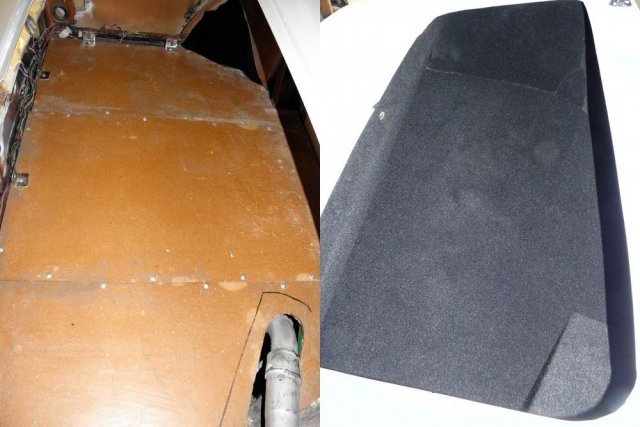

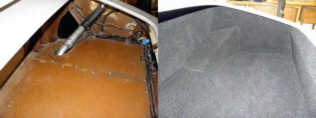

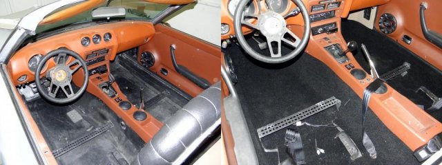

Fauxre Posted April 23, 2013 Author Share Posted April 23, 2013 Bought some cheap carpet at Home Depot to make a temporary interior. Covered the trunk and did a little two tone up front. It'll do for now. Quote Link to comment Share on other sites More sharing options...

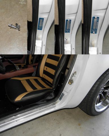

Fauxre Posted June 1, 2013 Author Share Posted June 1, 2013 Trip to CHP office was a breeze. All my paperwork was in order. The only snag occurred when I was told that the old vin plates had to come off and be surrendered. That meant a trip home to drill out the rivets. No big deal. With my old plates in hand, a new vin number was issued and a new plate affixed to the drivers door jam. The metallic tag has an adhesive backing, but two rivets are provided by CHP that must be installed by the owner. I was instructed to drill holes at the marked locations on the tag and tap the rivets into place with a hammer. The rivets act as anchors as well as anti-tamper devices. One more hoop to jump through before DMV title and registration is complete... Smog referee inspection next week. Quote Link to comment Share on other sites More sharing options...

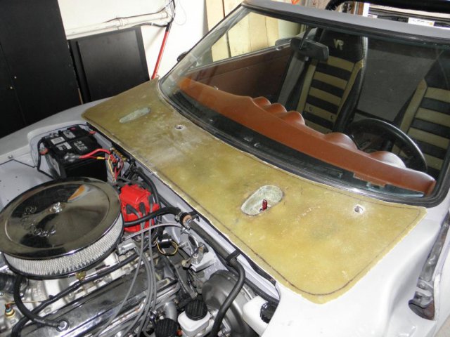

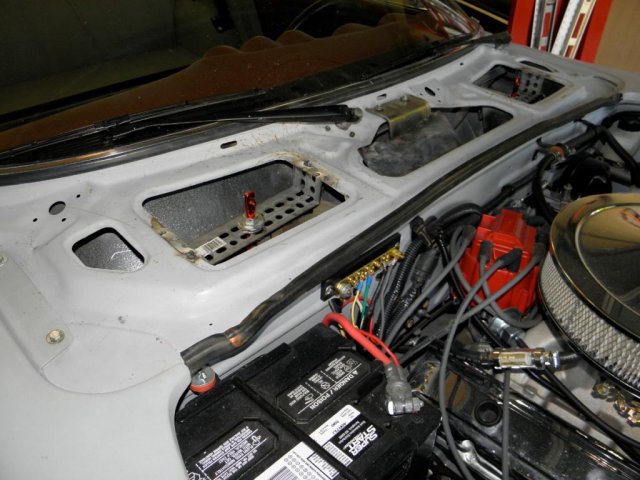

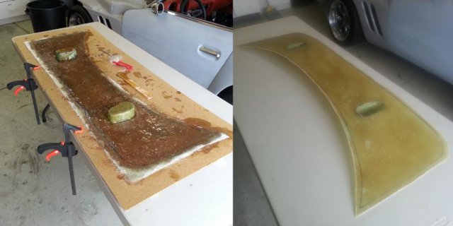

Fauxre Posted June 26, 2013 Author Share Posted June 26, 2013 I finally got the word yesterday... BAR approves!!!! I go back to the referee on friday to get my official smog exemption sticker affixed to the engine compartment. I was feeling sooooo good, that I started working on a new cowl for the old fresh air vents under the windshield. Using the cardboard mock-up..... I traced the part onto a piece of masonite. I carved floral blocks to make the recesses for the aero latches and hot glue them in position. I inserted shims under both ends of the masonite to get a slight curve. After a couple of coats of paste wax, the whole thing was covered in two layers of glass matte. After some trimming and sizing, I'll add sidewalls to get a rigid panel. Quote Link to comment Share on other sites More sharing options...

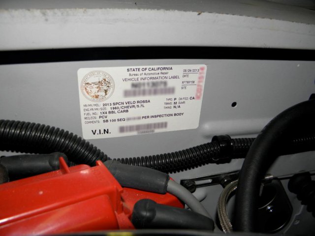

Fauxre Posted June 29, 2013 Author Share Posted June 29, 2013 Today was a really good day. The Velo Rossa title/registration process is complete. A trip to the Smog station this morning, a stop at DMV on the way back, and I now have this BAR sticker affixed to the firewall...this registration card that indicates NO model year...and two fresh new license plates waiting to be mounted. New title should arrive in 3-4 weeks.As daunting as this title/reg. process might seem at first blush, it's really not that bad and less expensive than I thought. $146 DMV Fees (partially based on vehicle value)$69 Brake inspection$59 Lamp inspection$0 CHP Vin verification / new tag$0 Smog inspection / sticker$274 Total Quote Link to comment Share on other sites More sharing options...
