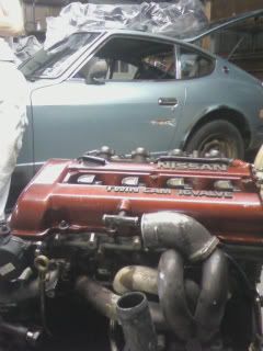

Daron Posted December 12, 2009 Share Posted December 12, 2009 Well, I have been waiting to post my progress on my 260 project and the day has come. My boy is better at the computer than I am, so I will get him to do most of the details and pictures. So far the car has made 371 rwhp on a dynamic dyno and low 12's at over 120 mph with a 1 legger diff which is being rectified this weekend {88 LSD 300zxt}. By the way, power was made on 93 octane. Next dyno trip will consist of 110 race fuel and 8500 rev limit. Hoping for 440 at the wheel. 2100 lb', 440 rwhp, good LSD, ET streets, hopefully 10's on the 1320. Quote Link to comment Share on other sites More sharing options...
Daron Posted December 20, 2009 Author Share Posted December 20, 2009 Went to the dyno yesterday with some 110 race fuel and made 415 rwhp on 24 lbs of boost. I'll post video link later. Quote Link to comment Share on other sites More sharing options...

Daron Posted April 7, 2010 Author Share Posted April 7, 2010 Here are a few pictures from the beginning to now. Quote Link to comment Share on other sites More sharing options...
Daron Posted April 7, 2010 Author Share Posted April 7, 2010 Here is the race gas 110 octane tune. 415rwhp 380rwtq on dyno dynamics. Quote Link to comment Share on other sites More sharing options...
