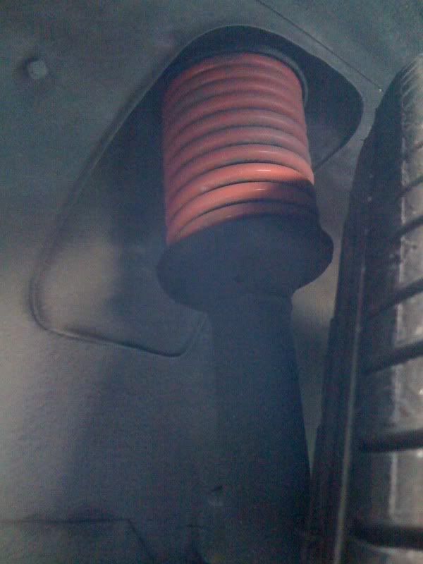

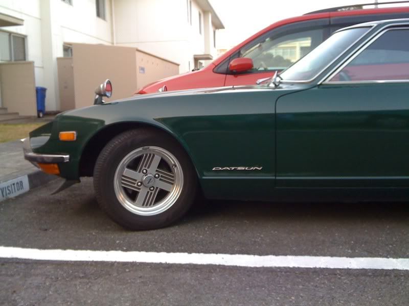

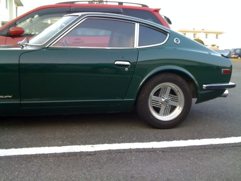

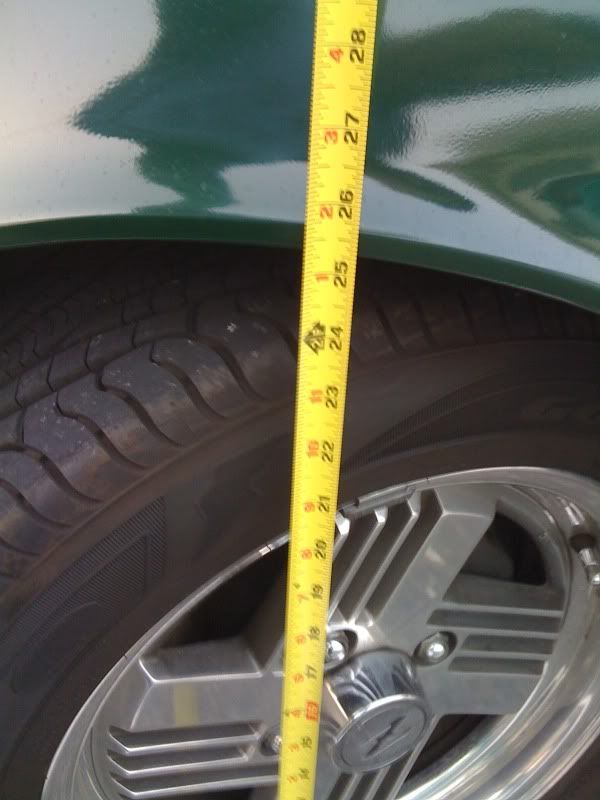

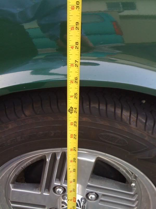

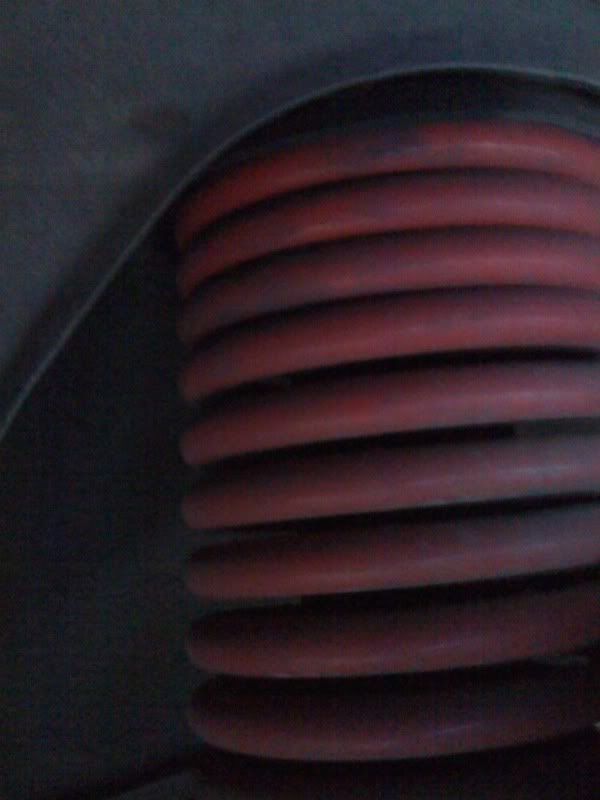

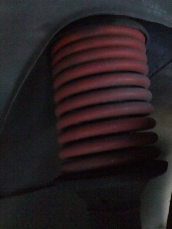

Konish Posted January 11, 2010 Author Share Posted January 11, 2010 Okay to flesh this out and as promised...pics! Anyone know what kind of springs these are? Also, it may not come across the pics, but the coils all have what seem to be around 1/4" between them. I am bottoming *badly* on pretty mild to intermediate bumps in the road. Her is the car as it sits now: And the tape rear: Front: Both at 25.5" from ground to the top pf the wheel arch using the wheel's center as a reference. I've read all the stickies and searched the issue. What is not clear to me is if I section the struts (doesn't seem too hard) but do NOT want to go with coilovers, then what option does that leave me for a spring perch (since I figure the stocker will get cut up beyond repair) R/ D Quote Link to comment Share on other sites More sharing options...
johnc Posted January 11, 2010 Share Posted January 11, 2010 You basically have 1.75" of bump travel before those spring coil bind. Repalce the springs with what I suggested above. Quote Link to comment Share on other sites More sharing options...
Kris.Is.Awesome Posted January 11, 2010 Share Posted January 11, 2010 You basically have 1.75" of bump travel before those spring coil bind. Repalce the springs with what I suggested above. Agreed- it's super obvious you're getting coil-bind. Quote Link to comment Share on other sites More sharing options...
auxilary Posted January 12, 2010 Share Posted January 12, 2010 wow. those coils have no compression left in them. replace them asap before you destroy the struts Quote Link to comment Share on other sites More sharing options...
Konish Posted January 12, 2010 Author Share Posted January 12, 2010 Confirms what I thought about the coils being pooped. Even though I'm newish to Zs, I'm not to cars and I've never seen a contemporary aftermarket coil this bad...I mean that spring can't be more than 5 years (probably less). I'm just crossing my fingers that the strut isn't bent or tweaked or the gland nut assembly isn't beat to crap. As per JohnC's advice but with stock 240z springs and Tokico Illuminas should set me up. Thanks! R/ Dustin Quote Link to comment Share on other sites More sharing options...
