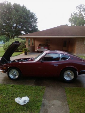

long240project Posted January 27, 2010 Author Share Posted January 27, 2010 Very clean engine bay. I like your routing of the trans cooler lines through the frame rail. I might have to do that next time my engine is out. I just found all the pictures from your project! Man! You got cool taste and great ideas! Like the car! Sorry just found the pics at little slow ha! Lane Quote Link to comment Share on other sites More sharing options...
Kevin.pk Posted January 28, 2010 Share Posted January 28, 2010 I just found all the pictures from your project! Man! You got cool taste and great ideas! Like the car! Sorry just found the pics at little slow ha! Lane Thanks for the kind words, and likewise on your car. I kind of wish I would have went with a louder color like your red. Guess I'll just have to build another Z. lol Quote Link to comment Share on other sites More sharing options...
long240project Posted January 28, 2010 Author Share Posted January 28, 2010 Kevin, You are a braver man than I!! These lil Zs put up a mean fight!! I wave the white flag for the next build. LOL Lane:icon2: Quote Link to comment Share on other sites More sharing options...
Kevin.pk Posted January 29, 2010 Share Posted January 29, 2010 Kevin, You are a braver man than I!! These lil Zs put up a mean fight!! I wave the white flag for the next build. LOL Lane:icon2: No plans for another for a while, lol. This one was hard enough on the wallet. I was looking at your engine pic. Is that a super victor intake? Curious if you managed to get that filter under the stock hood somehow. I ask because that's the intake I have and at the moment I'm using something akin to a riding lawnmower air filter on my carb for hood clearance reasons. I need to experiment with some dropbase filters and such. I know you're not using the JTR mounts like I am but thought I'd ask anyways. If I had to guess you probably have a cowl hood though. Quote Link to comment Share on other sites More sharing options...
long240project Posted January 29, 2010 Author Share Posted January 29, 2010 Kev, You are correct I have a cowl hood. I wanna say it's the 4 1/2'' from unlimited. I know..I know that is a little over kill but I am kind of partial to the drag car look. I have a 2'' Cowl that I took off of the car before I got the bright idea to dismantle it into a million pieces. If you or anyone is interested in it. Lane Quote Link to comment Share on other sites More sharing options...

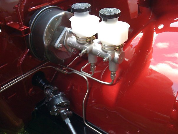

long240project Posted February 2, 2010 Author Share Posted February 2, 2010 Mark, I was unaware that there was anything in Mandeville! Thats cool to know. That's a beautiful town so probably a cool event! Keep me posted on that! Man I am so freaking ready for this job I am on to end! It's a catch 22. The longer I stay the more Z parts can be purchased with a clean concious! lol... but I am ready to install whats on the door step now! I made a rookie mistake with the brake upgrade by not buying the 15/16 master cylinder. Going from two pistons and two baby wheel cylinders to 16 pistons demands a lot more volume. I don't know what I was thinking!! I ordered a 15/16 bore base and my reservoirs are supposed to go on it. I'll be able to pass along exactly how much difference the two volumes make as soon I get home. Also the entire lot of things that go along with plumbing and wiring the car have arrived! It will rumble by mid March!!! Lane Quote Link to comment Share on other sites More sharing options...
