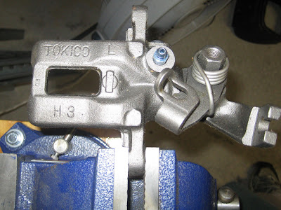

So in what surely can only be described as a complete act of idiocy, I decided to rebuild my 200sx rear calipers when I had them powder coated.
I was inclined to do this as I was doing my front S12+8 and it "seemed" like a good idea at the time.
These were Rock Auto rebuild specials that I got for like $30

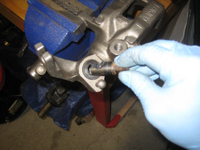

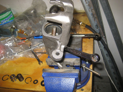

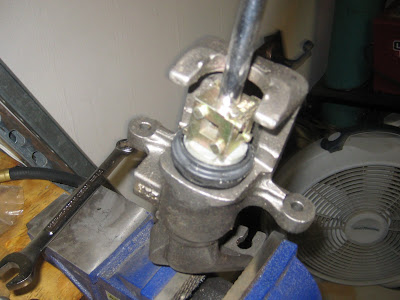

They came apart easy enough:

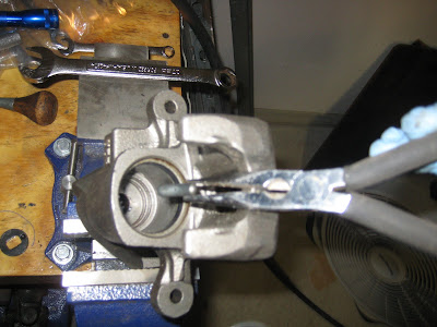

So at this point... right here:

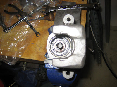

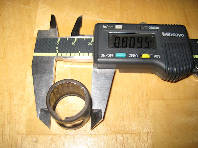

My spider sense SHOULD have been tingling... see that roller bearing in there?
Here let me help out a little:
it's part number 44130 in this diagram courtesy of Courtesy Nissan (NLA).

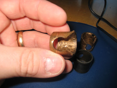

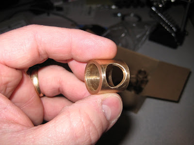

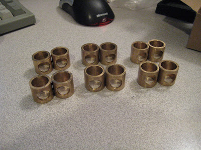

It is a VERY special little bearing... one that is obviously expensive as later rebuilders bypassed replacing it and used bronze:
So I know what you are thinking... why didn't he just leave them in there... I mean did they NEED to come out?
So this is yet another thing that I have made peace with myself by pretending that the previous owner had done this.
All of this brings me to my question for the forum: Any one ever replace this before?

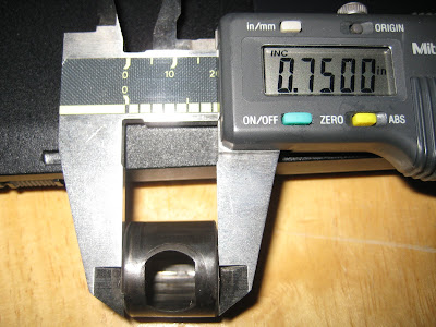

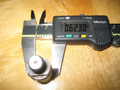

Here are some better pictures of the sizes of the parts in question:

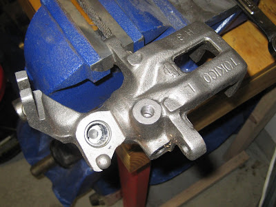

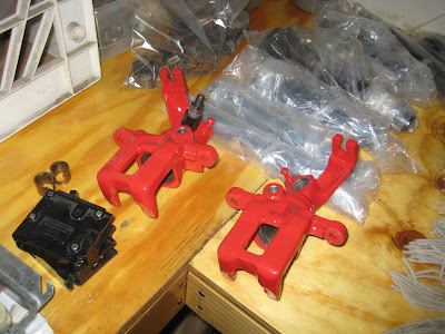

Powder coated caliper bodies are lonely:

I've done the same disassembly with another set of rear calipers with built in parking brakes. I left the bearing in, told the shop to take care not to get any sand blasting media in them, had the powder coated. Once I got them back, I had sprayed out the bearings with a cleaner and compressed air to get out any possible blasting media and the old hardened grease. I repaced them with grease, reassembled them and haven't had an issue since.
