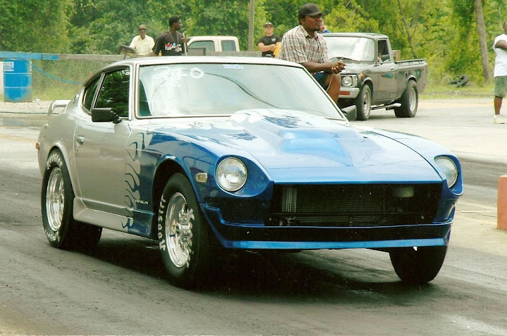

19762802+2 Posted January 28, 2010 Share Posted January 28, 2010 I'd like to hide the bottom of the radiator, shave the turn signals, and fill the gaps... just one piece of fiberglass or urethane that wraps around the bottom and comes up just under the lights would be ideal. Sort of like this? the guy is a member here his username is aziza z. I think its custom built off a MSA air dam. You could pm him for details. http://i45.photobucket.com/albums/f60/bemmerguy714/IMG_1668.jpg Quote Link to comment Share on other sites More sharing options...
Hugh Posted January 28, 2010 Author Share Posted January 28, 2010 The best custom grill I've seen was done by member HLS30-08077. You can see some pics of it here: http://www.cardomain.com/ride/2635267 I can't find a writeup of how he made it though. That is sweet! Doesn't look overly complicated - just time consuming. Not sure what he used for spacer blocks, but the main pieces look like your typical L-shaped aluminum pieces you can buy at Home Depot. Quote Link to comment Share on other sites More sharing options...
Hugh Posted January 28, 2010 Author Share Posted January 28, 2010 Sort of like this? the guy is a member here his username is aziza z. I think its custom built off a MSA air dam. You could pm him for details. http://i45.photobucket.com/albums/f60/bemmerguy714/IMG_1668.jpg Sort of... but I would want it to curve backward under the lights toward the wheels. This one looks too modern for my taste, but you got the right idea. Maybe I can photoshop something. After looking at more pics of these, I'm almost thinking I have to keep the turn signals in place to break up that huge space. Otherwise it looks like a flat wall. (lifted from other thread for example) If that space were filled in... I don't know. Quote Link to comment Share on other sites More sharing options...

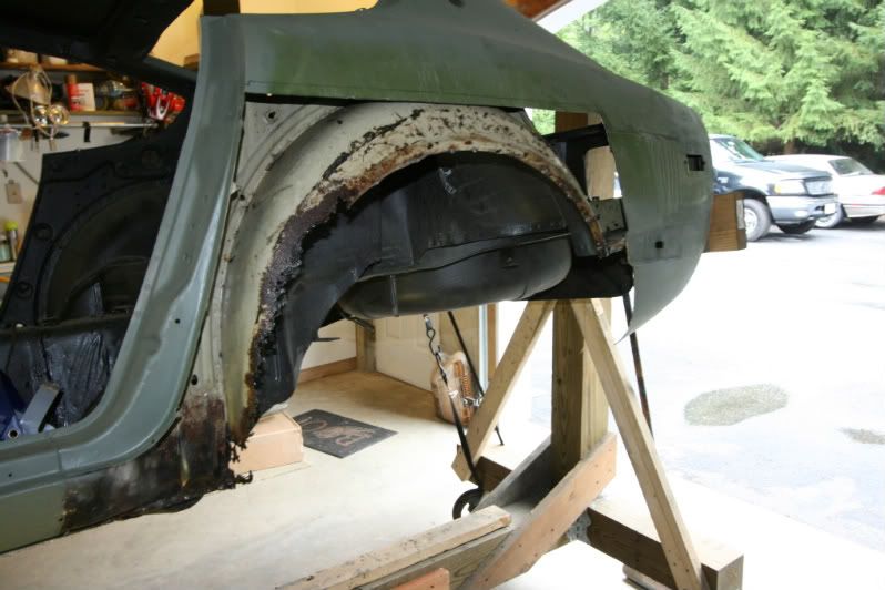

Philly_G35 Posted January 28, 2010 Share Posted January 28, 2010 Prices were higher than on the website, but not too much more. The pieces seemed to fit pretty well based on my amateur experience. Here is a picture of what I started with. Here is the only photo I currently have showing the repaired quarter panel and wheel well. You can also see where we welded in a panel to fill in the indent from the bumper. We still need to finish the body work. Quote Link to comment Share on other sites More sharing options...
Hugh Posted January 28, 2010 Author Share Posted January 28, 2010 Well that looks good to me. I'm having a pro do the work, so I'm sure he can clean it up and make it look like nothing ever happened. I had to cut out my wheel wells to fit the 245 50/15's that I had out back. Now I can't even find tires that size so I'm running Yokohama ES100's that are 225 50/15. I wonder if these would clear the stock wheel wells or not... maybe I can get someone to try them out on a stock body Z and see if they rub? If they don't rub, then I will do that whole piece like you did. If they do.. then I'll have to have them chop them out or roll them Quote Link to comment Share on other sites More sharing options...
