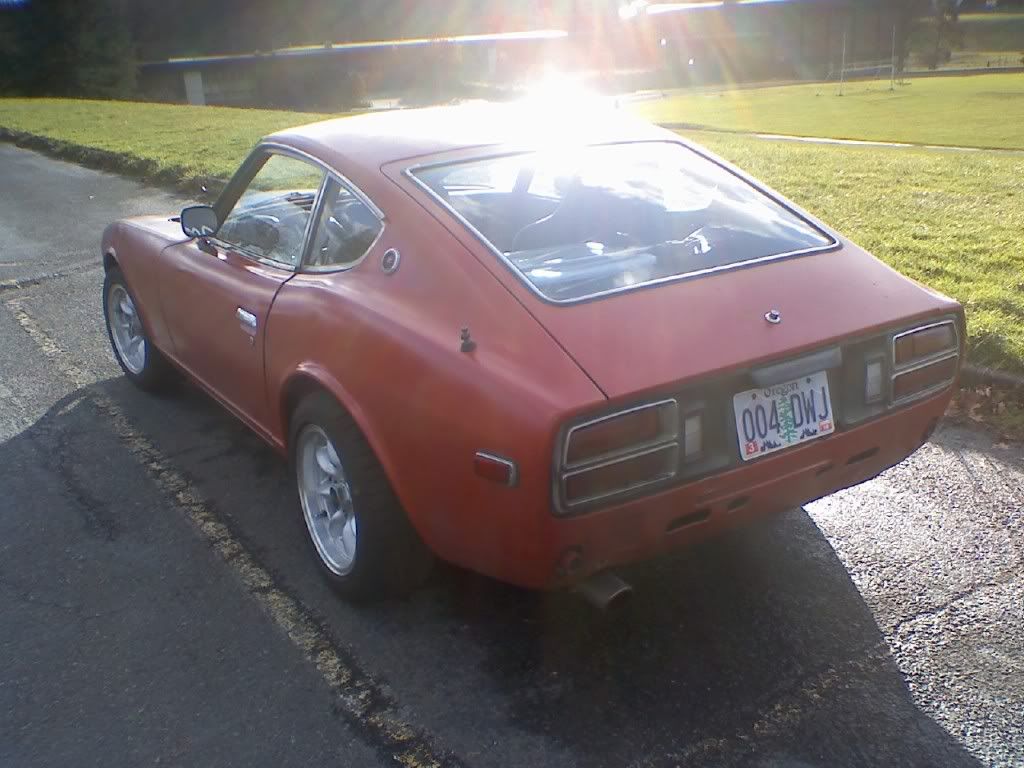

You should be ok. I run 205-50-15s on 15x7 Panasports and the tire isnt stretched at all (picture for reference, sorry not the best quality). I'd be careful though, my wheels are 0 offset (I think) and the tires are fairly close to rubbing on the lower spring perch on the front. With a +15 offset it might necessitate a wheel spacer...
