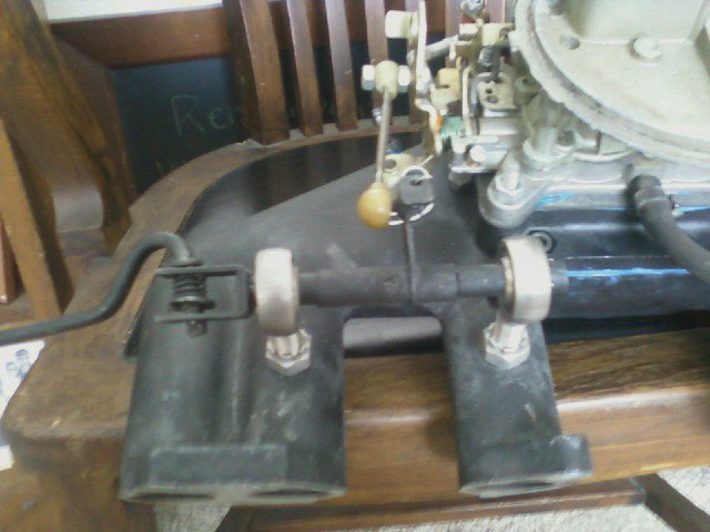

I think I might have something for you :D, I will get pictures tomorrow when I can. Think stock linkage ,so no modifying the car, and this.
Not sure what the exact name is for these things but thats what the PO of my Clifford intake used. Its pretty nifty.

I'm lucky my parts car soon to be Street car has AC :D, but Those end links that I gave a picture are the only parts you need to buy the rest the PO made himself he just cut a small piece of aluminum tube and some other stuff only pictures can do it justice. Maybe for the right price I will just give you the whole intake, I heard the AZ Intake is for HP and the Clifford is more for Torque ;). But next year I plan on driving my Z down there for some Car show my girlfriend has told me about but I have been able to be down there at the right time. It looks like the snow is not gonna let up till tomorrow so I will just run outside and grab it and bring it in for some pictures.
Took a small video of how it works and some pictures.

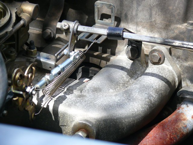

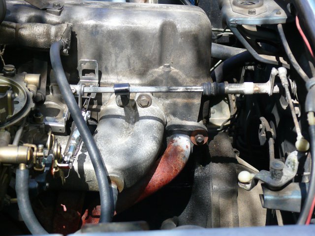

Ok, so this is what I have come up with so far. Its only a temporary set up until I find the parts I like and get them set up.

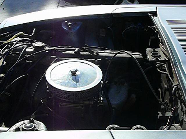

First one is a pic of the cable linkage that I didn't like. I just couldn't get it to move smoothly enough for me.
These next few are how it is now. Very smooth opperation like I want, just not flashy enough B)
