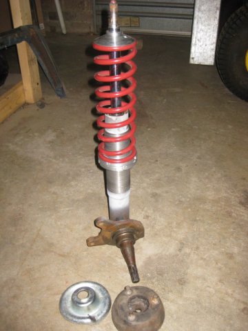

mossy74 Posted April 25, 2010 Share Posted April 25, 2010 Can anyone tell me what parts are needed to put my coilovers back together, I have the GC top hat on now, does the factory spring seat and rubber isolator go on top of this? Quote Link to comment Share on other sites More sharing options...

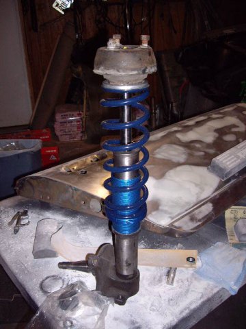

jkgts1 Posted April 26, 2010 Share Posted April 26, 2010 Can anyone tell me what parts are needed to put my coilovers back together, I have the GC top hat on now, does the factory spring seat and rubber isolator go on top of this? I don't think you need the factory spring seat, just the insolator, if you are not using some kind of camber plate. This is what I did with mine. Quote Link to comment Share on other sites More sharing options...
mossy74 Posted April 27, 2010 Author Share Posted April 27, 2010 Thanks, it looks like you have a flat top hat compared to my dome hopefully it should be fine. Quote Link to comment Share on other sites More sharing options...
junglist Posted April 27, 2010 Share Posted April 27, 2010 Thanks, it looks like you have a flat top hat compared to my dome hopefully it should be fine. It is fine that way, you just lose a little bit more suspension travel with the curved top hat like on Ground Control and Techno Toy coilovers compared to the flat one that Modern Motorsports provides. Quote Link to comment Share on other sites More sharing options...
