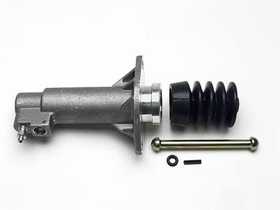

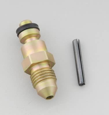

gvincent Posted May 12, 2010 Share Posted May 12, 2010 There have been a few threads on this over the years, I know I either replied or posted. I used a Tilton 7/8 master and AN-4 fitting and braided hose, I forget which AutoZone T5 METAL slave I used but it had the GM Qwik-Connect fitting and I needed an adaptor. The T5 slave has a bleed screw. I have had no clutch problems so far and I have enough travel. Probably a search for T5 slave might show up more. try here: http://forums.hybrid..._1entry687777 Here are pics of what I used. Don't loose that freaking pin. it was almost impossible to find one, no local GM dealer had one, some guy on LS1/LT1.com that rebuilds T56 transmissions felt bad for me and dropped two in the mail. Good luck, Greg Quote Link to comment Share on other sites More sharing options...
Bezy240 Posted May 12, 2010 Author Share Posted May 12, 2010 Thank you guys. I got the slave cylinder. now I have to find the rest of the fittings. I am going to order the tilton 7/8 master from summit 75-875N and then worry about the plumming next. Quote Link to comment Share on other sites More sharing options...
Bezy240 Posted May 26, 2010 Author Share Posted May 26, 2010 The setup was perfect. everything worked out great. thank you Gvincent Quote Link to comment Share on other sites More sharing options...
