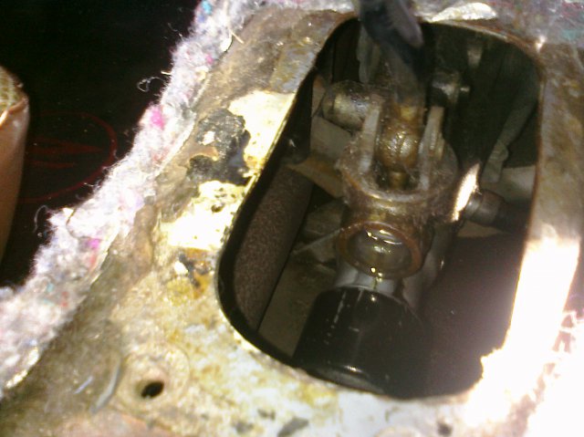

It is leaking out of the gear change lever area. The tube that comes out the back doesn't have a cap on it. Not sure if it is supposed to, or if there needs to be a better seal around where the shifter control arm connects inside that assembly.

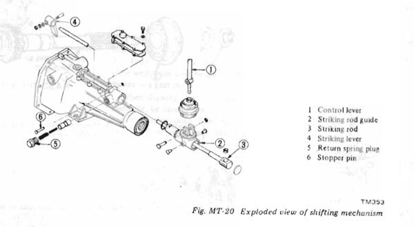

I got the pic from my FSM, but I know the trans isn't from a 75 but the diagram looks close. I also took a pic of my shifter. I did a search on MSA for a part that looks similar in description. Is that what I need?
Final question. While this is out, should I do a short shifter right now? If so, how can I tell what trans model I have to see what short shifter I need?
The end cap isn't numbered or named.
You can see the gear oil leaking out the back of the assembly.

No one really helped on here... but yeah my shop ordered a few plugs and we found one that fit. We could not find a part number for the plug on the end so we just measured the hole and ordered some in that size to see what fit best. I have not notice it leaking more, but I have not changed the gear oil yet and I need to do that as well. One thing at a time.
There is definitely supposed to be a plug there. I'm not sure how it would have fallen out, because IIRC, it would have been staked in place originally. There is also supposed to be a rubber boot over the shift linkage, which, judging by the gunk built up around it, has been missing for a while. That should be replaced too, or dirt is going to end up in the transmission.
