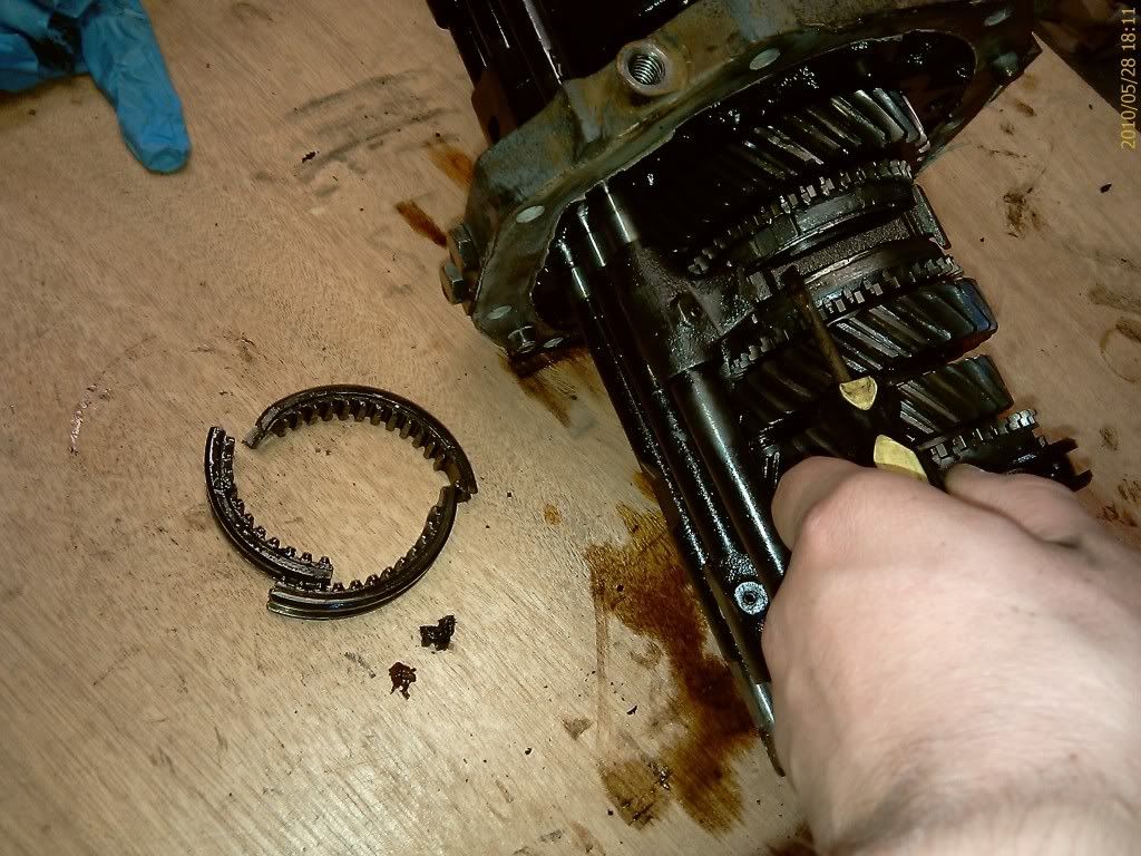

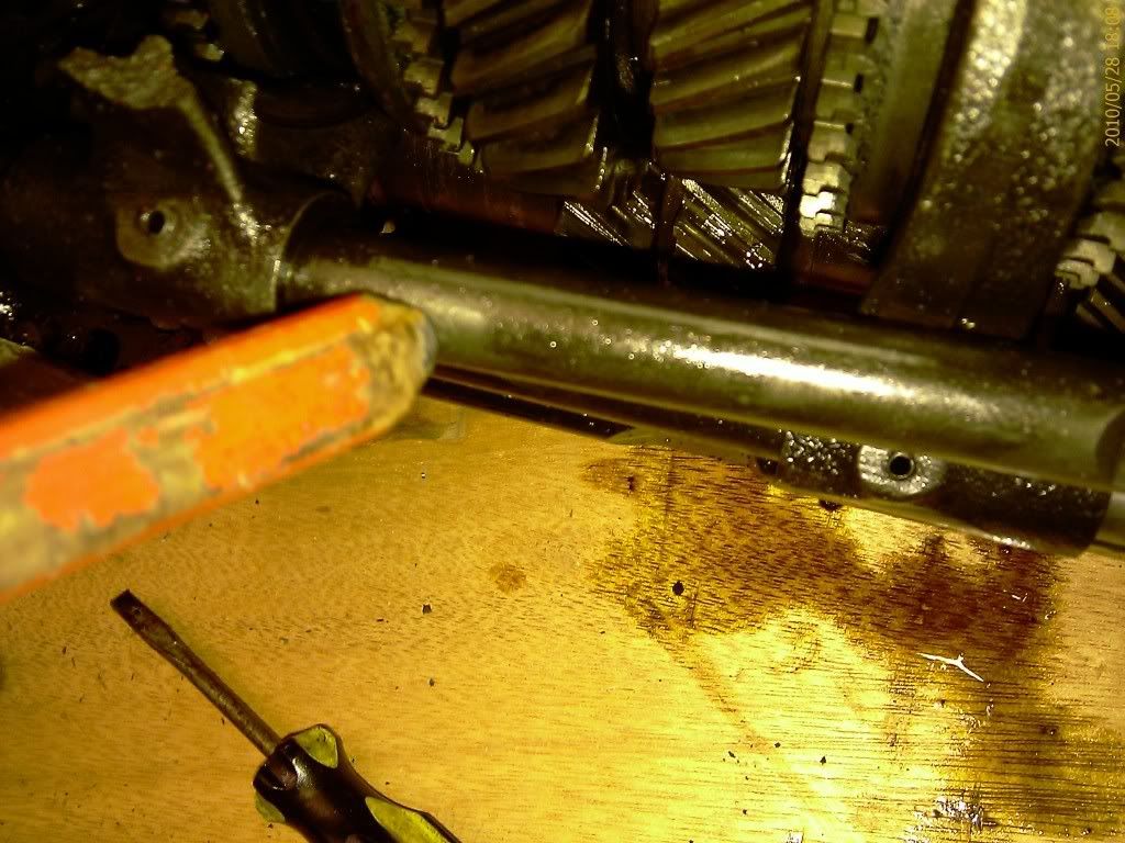

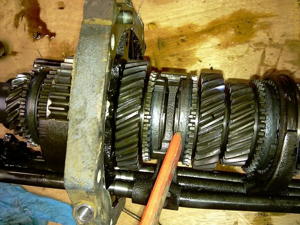

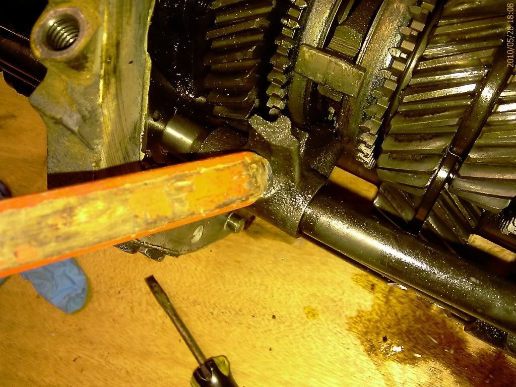

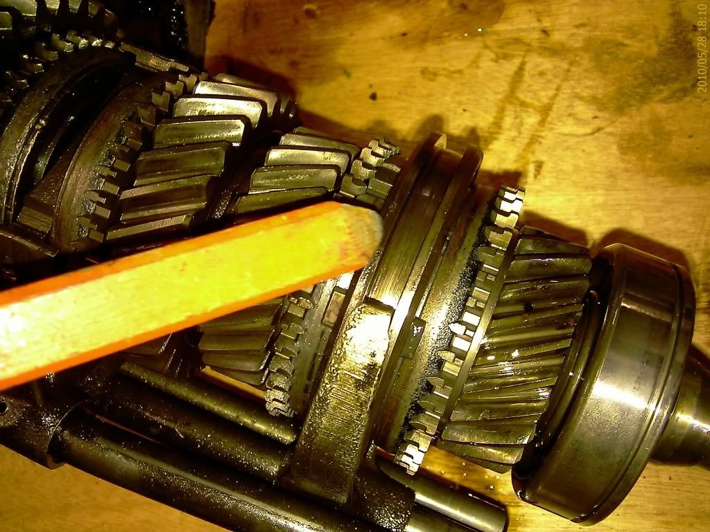

KnightoftheRound Posted May 28, 2010 Share Posted May 28, 2010 Hey, I have this Datsun Competition close ratio 5-speed with the direct drive 5th gear, and need a couple parts to repair it with. It needs the first/second shift rod and fork, all four synchros, and both couplings, I took pictures of the needed parts. "Coupling" Synchos Rod and Fork Any help sourcing parts is greatly appreciated, I had heard that the Datsun 2000 Roadster 5-speeds were very similar. Quote Link to comment Share on other sites More sharing options...

KnightoftheRound Posted June 9, 2010 Author Share Posted June 9, 2010 Sent Sam some money for a modified 4 speed fork, haven't tried to bend the rod back yet. To put a rest to the Porsche synchro "coupler" thing (the piece the fork goes over, and slides over the synchros to engage gears), I took my GOOD ring to Abacus Racing here in Virginia Beach, they have an EXCELLENT exotic car repair team, and when I went in that section of the shop, all they HAD were old British, German, and Italian cars, engines out, transmission apart, etc, including a full blown race setup 911, and a GORGEOUS 964 Turbo...anyways I spoke to the mechanic there, and he said that they were the same ring, but he didn't have one to compare with at the time. From there, I was sent Don Schneider of German Autowerks, also here in Virginia Beach, who DID had some of the rings lying around for matching purposes. We compared the rings and he confirmed for me that the INNER part of the ring with the teeth was identical, and it really was. The GROOVE that the fork fits into on the other hand is NARROWER, but he said that any good, reputable machine shop SHOULD be able to machine the groove out larger without much trouble, especially if you have the fork or ring that came out of it for the shop to look at. The transmission parts would be from a early-mid 70s Porsche, but I have forgotten the kind of car, I have to go back up to see him when I get the fork in to compare some more things, but this is a good start! The only downside is that the couplers are $225 each new through him, and are probably even MORE expensive through a dealer, but are in fact available. Quote Link to comment Share on other sites More sharing options...
JMortensen Posted June 9, 2010 Share Posted June 9, 2010 OK, I misunderstood your PM. So the "selector ring" that the fork fits onto is the same but the groove needs to be opened up. Got that. How about the synchro ring itself? That's the piece that usually wears out or breaks. Did you even check to see if that fits? I would guess that a worn synchro might have caused a jamming of the selector ring into the dog teeth which broke it in the first place. I'm a bit embarrassed to admit it but I didn't open up the pics at the start of the thread. Porsches commonly break the synchro rings, and I assumed that's what I was looking at when I saw the three broken pieces of the selector ring that you showed in the pics. Oh well, I guess I turned you onto a solution. What is kind of funny is that in another thread I was told that the selector rings didn't fit. Maybe they just didn't think to open up the groove on the outside. Quote Link to comment Share on other sites More sharing options...
