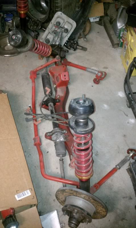

powdercoated underneath with GC coilover, sectioned tubes with MR2 front struts and TTT camber plates.

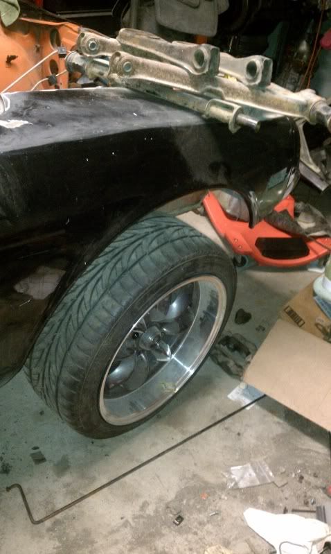

old z, i know some people will think i'm crazy...but this one is honestly in much better condition. i don't have to deal with PO fixes.

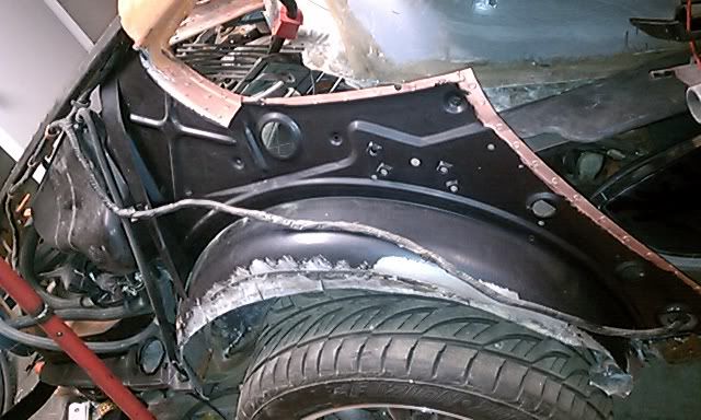

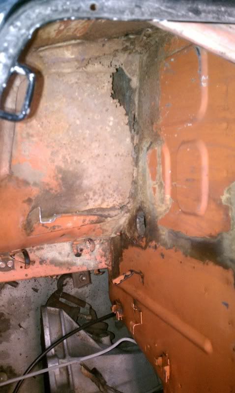

i got some new rear quarters from a 260z, i will use parts from that to patch this area, it's literally the side of the car since the panel was cut on the inside up through the wheel well...that area was rust free on the 260z..im doing both sides.
rear suspension
the seams at the rear roll pan had rust, as did the orignal quarter fender lips. as i cut the lips off i saw rust up inside...it appears this car was not dipped after assembly. so i blasted the area clean and por15 it all, also applied weld through primer where i will be reattaching the quarter.
i will be welding to the inner panel so it will go out straight to meet the outer fender where i will attach the fiberglass flares.
same with the rear roll pan area..this had some surface rust...blasted and por15ed
4x4 stance
the parts that are going in. i will be putting in camber plates. i used the top hats to mount them on the 73 so i could roll it.

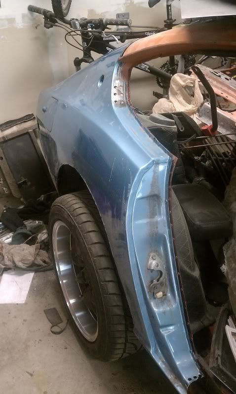

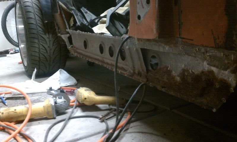

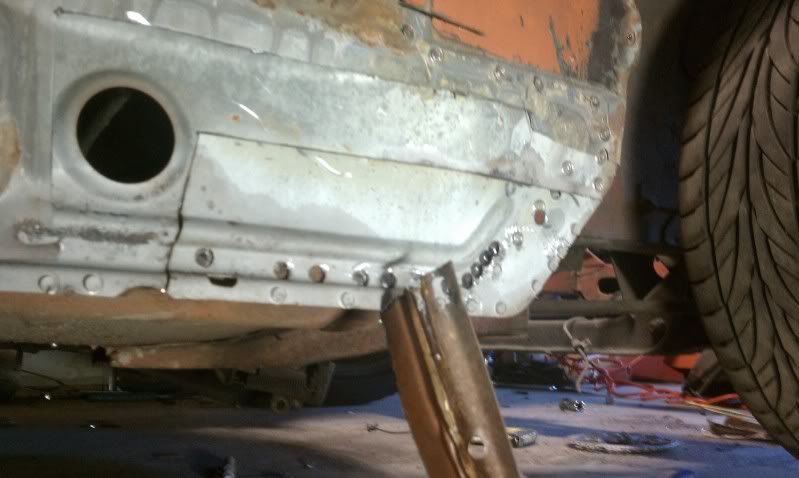

been workin on seperating the rear quarters i picked up...i got one side off, still need to finish the rocker before i can begin the plug weld all the holes drilled out from the spot welds...i will be welding the highest portion of the inner fender straight out to meet the quarter panel.

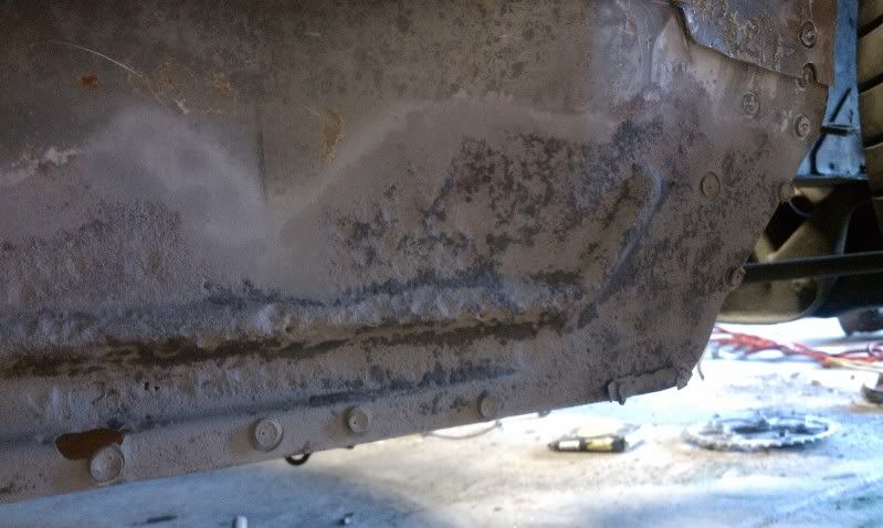

start taking the lower rocker dogleg area apart...to use on the 72. i'm gonna media blast and por15 these pieces and then reinstall and weld in place.

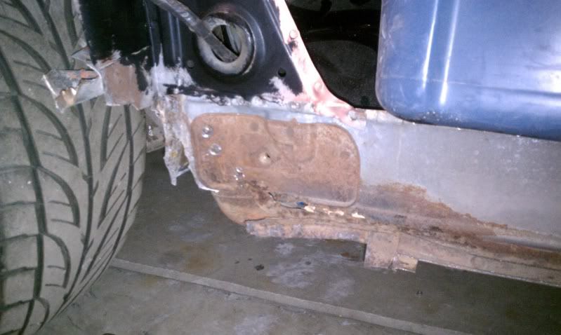

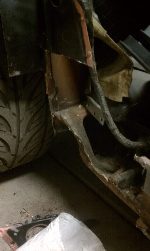

inner rocker where seatbelt mounts, lower portion destroyed on the 72..will be using this to repair
here is the inner dog leg area...it's the part seen from the inside...and gets sandwiched between the inner and outer rocker panel.

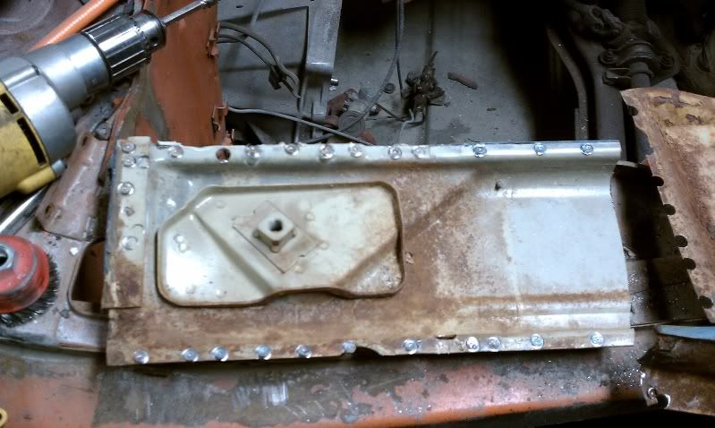

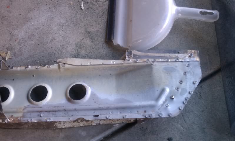

i don't get a lot of time to work on the car...but i did break out the media blaster and clean up some of the parts...i'm workin on the inside rocker around the seat belt mount. i have all the donor parts i removed with a spot weld bit...so i dont have to fabricate anything...just pinch it with some plug weld pliers and put her back together...using por15 and weld through primer at the plug welds.
heres the part i took out...
the top of the 240z inner rocker was fine...the bottom was gone...the seatbelt mounts between the two are different..so i used the 280z inner rocker...removed the plate on the backside that the seatbelt bolts to....and pieced them together...i'm out of gas on the welder...it will get welded later...i will fill in the holes as well so it will look like the inside of a 240z rocker.

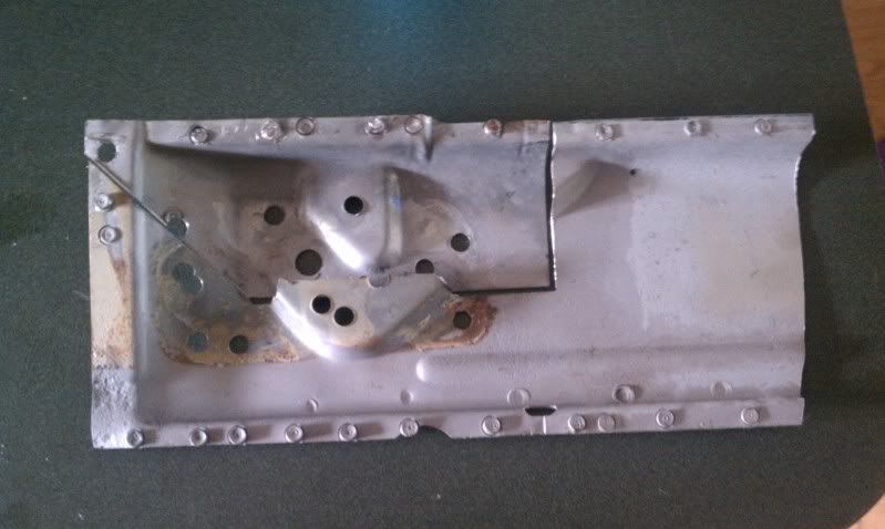

and here's whats removed...i will be blasting the inside of the rocker later today...getting rid of all rust...and then coating with por15.
i think i have some form of OCD...i know most people don't bother if it hasn't eaten all the way through...but if i did leave it the thought of not knowing quite how bad it was...would tear me up...and i plan on keeping this car for a while.
Edited by bobbyc

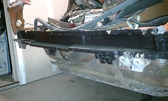

i started blasting and the results were what i expected but was hoping i wouldn't have. the metal is heavily pitted from all the rust...and there are a few holes. it'd prob be fine to just slap some por15 on it and take the welder to build up the heavy pits...but i'm going to replace it.
here's the donor...while i was blasting i cleaned it up too.
hopefully tonight i can get all the spot welds drilled out and get it fitted...i didn't make it to the welders to get gas...i don't have another day off for another 6 days so it may have to wait til then.
fixing it wasn't too difficult...only took about 30 min...just need my dang welder and i could make some real progress!
