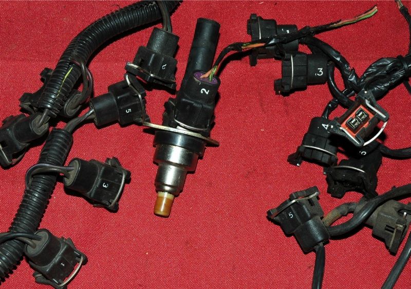

Administrators BRAAP Posted August 10, 2010 Administrators Share Posted August 10, 2010 Most of the European, Japanese, and domestic cars and trucks with Multi Port EFI from the '80's through the '90 and even into the 2000's also use this same style BOSCH connector and are interchangeable, (that style of EFI connector is probably the most widely used two pin electrical connector in the world). A revised version of that connector was used on late '80's through '90's GM products such as H body, X body cars like the Pontiac, Buick, Olds, Chevy FWD cars and use a quick release style clip. Especially for use in an injector test/cleaning rig, this quick release push style clip vs the clumsy pick-and-bust the connector style clip is much nicer, quicker, and easier to use. I use these on all my customers EFI Z cars as well as my injector cleaning/test rig. They are plentiful and cheap, used and new. If you hit the wrecking yard and get the GM ones used, they are usually still in pretty good shape as they seem to hold up much better than the Hitachi versions from the '70's as used on our Z cars and they are numbered 1-6, (not that it matter's the Datusn EFI is batch fire, they all open and close at the same time). Another Member of HBZ, Matt Cramer of DIY-Autotune sells these connectors new, with pigtail ready to use or just the pins and concetor ready for you to build your own pigtail. http://www.diyautotune.com/catalog/fuel-injector-pigtails-bosch-ev1-p-48.html http://www.diyautotune.com/catalog/fuel-injector-connector-bosch-ev1-p-111.html Hope that helps, Paul Quote Link to comment Share on other sites More sharing options...
beebeecivic Posted August 10, 2010 Author Share Posted August 10, 2010 On 8/10/2010 at 3:57 PM, BRAAP said: Most of the European, Japanese, and domestic cars and trucks with Multi Port EFI from the '80's through the '90 and even into the 2000's also use this same style BOSCH connector and are interchangeable, (that style of EFI connector is probably the most widely used two pin electrical connector in the world). A revised version of that connector was used on late '80's through '90's GM products such as H body, X body cars like the Pontiac, Buick, Olds, Chevy FWD cars and use a quick release style clip. Especially for use in an injector test/cleaning rig, this quick release push style clip vs the clumsy pick-and-bust the connector style clip is much nicer, quicker, and easier to use. I use these on all my customers EFI Z cars as well as my injector cleaning/test rig. They are plentiful and cheap, used and new. If you hit the wrecking yard and get the GM ones used, they are usually still in pretty good shape as they seem to hold up much better than the Hitachi versions from the '70's as used on our Z cars and they are numbered 1-6, (not that it matter's the Datusn EFI is batch fire, they all open and close at the same time). Another Member of HBZ, Matt Cramer of DIY-Autotune sells these connectors new, with pigtail ready to use or just the pins and concetor ready for you to build your own pigtail. http://www.diyautotune.com/catalog/fuel-injector-pigtails-bosch-ev1-p-48.html http://www.diyautotune.com/catalog/fuel-injector-connector-bosch-ev1-p-111.html Hope that helps, Paul Thank you BRAP!! exactly what im looking for! Quote Link to comment Share on other sites More sharing options...

19762802+2 Posted August 25, 2010 Share Posted August 25, 2010 The older Volvo injector clips also have the Push off clips and are pretty easy to find for cheap at the junkyard. Quote Link to comment Share on other sites More sharing options...
Xnke Posted August 29, 2010 Share Posted August 29, 2010 Mitsubishi has the thumb-latch style EV-1 connectors all over the engine bay. There are five or six in a single car. Quote Link to comment Share on other sites More sharing options...
