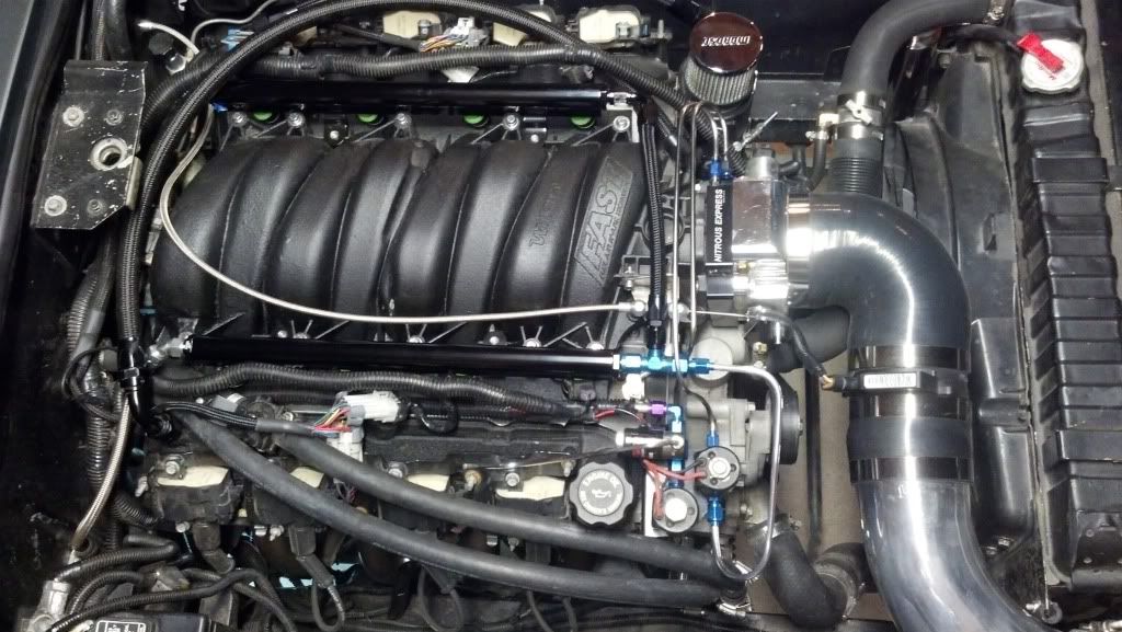

SUNNY Z Posted May 23, 2013 Author Share Posted May 23, 2013 (edited) Well I'm still waiting on a fitting that was SUPPOSED to have shipped friday. So, we'll see on the dyno. Planning on for sure going to the track friday night though. I had a near near death experience this last weekend, and is some good food for thought for you guys running stock fuel rails. The quick connect that goes onto the rail, and converts to an AN fitting came off in the middle of a pull, and sprayed gas EVERYWHERE in my engine bay. Luckily, it didn't catch fire. Nothing wrong with it other than it has been taken off maybe 6-7 times. If you have one of these, NEVER take it off the rail, instead, decouple the threads. I bought some Holley fuel rails (really nice, and only $130. I did have to re-bend two of my hard lines for the N2O however. Here tis! Safety AND bling. Always a winner in my book. Edited May 23, 2013 by SUNNY Z Quote Link to comment Share on other sites More sharing options...
240z72 Posted May 23, 2013 Share Posted May 23, 2013 Wow that's damn scary. Good choice on new rails. Stock rail works but never liked the look or how it had that push on fitting. I have three on my filter and they seem cheezy. Looken great! Quote Link to comment Share on other sites More sharing options...
RebekahsZ Posted May 23, 2013 Share Posted May 23, 2013 Yeah, those quick disconnectsl look sketch to me too. I had an AN fitting welded to my stock rail. Quote Link to comment Share on other sites More sharing options...
