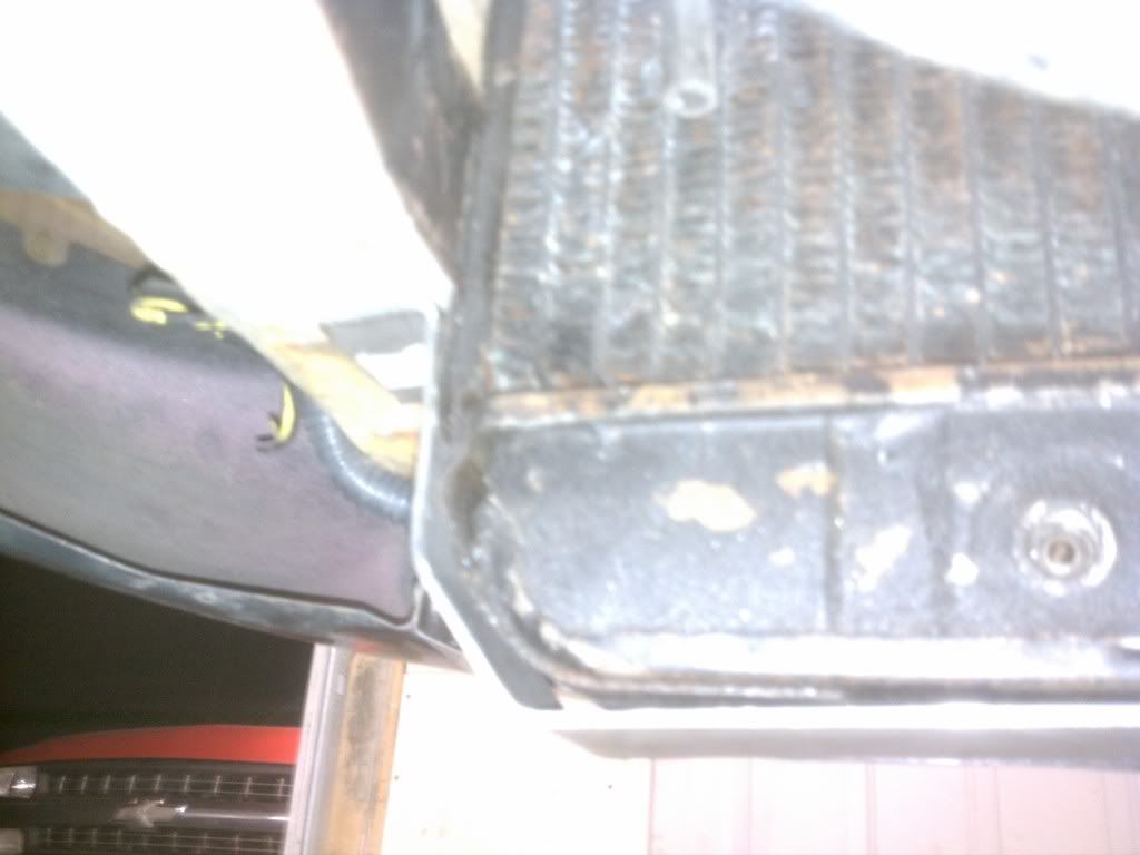

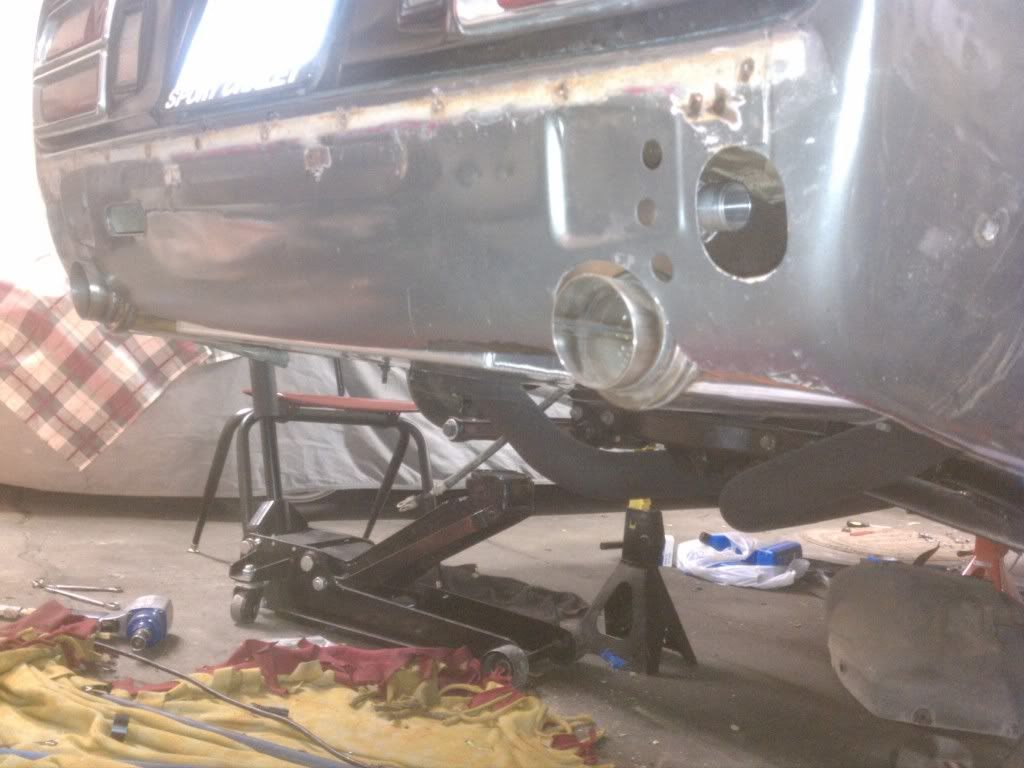

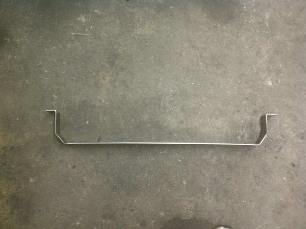

SUNNY Z Posted March 29, 2012 Author Share Posted March 29, 2012 (edited) Made it to the shop the other night. Got a piece of 2"x1/8"x3' took some measurements, bent it in my vise with a hammer, made a lower radiator support. (not done yet) Fit is good. Uses the front tow hook mounts, which are ghandi. Also welded a strap between the front exhaust pipes so they're always indexed correctly. And VHT high-temp painted them. Le flat black Also ordered tires, fender flares, front air dam, and other misc junk Edited March 30, 2012 by SUNNY Z Quote Link to comment Share on other sites More sharing options...

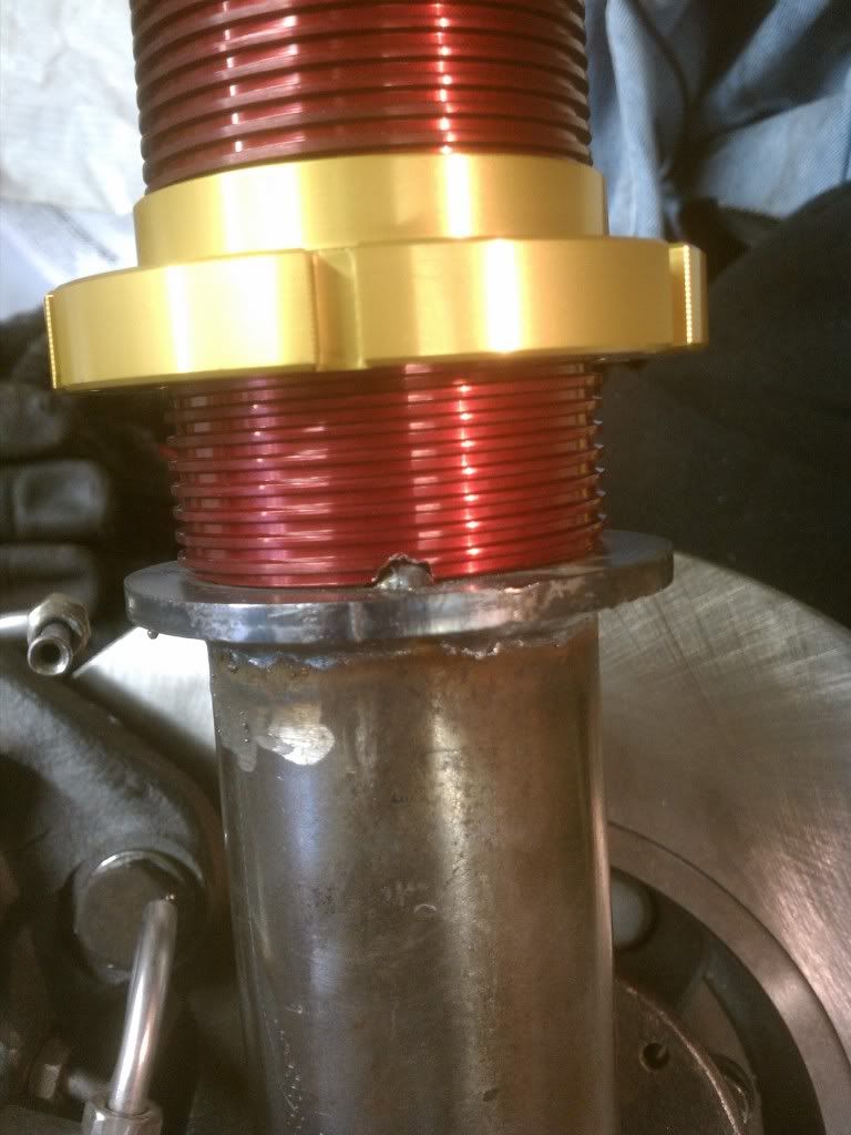

SUNNY Z Posted March 30, 2012 Author Share Posted March 30, 2012 Spent another evening down at the shop last night. Finished painting the rear strut tubes, got the correct spacing for the front brakes, and got the front strut tubes primed. Little word to the wise: a good friend of mine told me to do this: so the collars don't rotate when you are adjusting the ride height. Smart! also, since my tokico's are smaller than the strut tube, the fronts wouldn't center correctly with the stock datsun gland nuts. SO, I cut the locating ring off the ones that came with the shocks, and tacked in on the datsun gland nuts. Worked great! I also completely finished the radiator support, and found some hoses that will work. No pics yet, but soon! Quote Link to comment Share on other sites More sharing options...

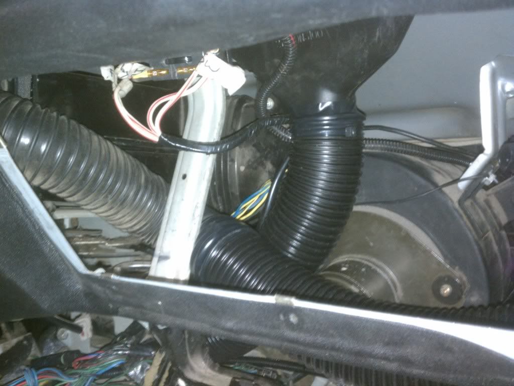

SUNNY Z Posted April 9, 2012 Author Share Posted April 9, 2012 (edited) Fuel Tank, camber plates, TC rods, and bump steer spacers will be here tuesday. In the meantime, I was able to get one rear strut in, and get a mock up of the flares. I also finished the vent tubing under the dash. I used a 2.5" shop-vac hose that I bought at Menard's for like $20. Turned out its almost exactly the right size. I also got the air dam mounted Thats all for tonight! Edited April 9, 2012 by SUNNY Z Quote Link to comment Share on other sites More sharing options...

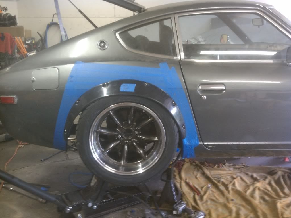

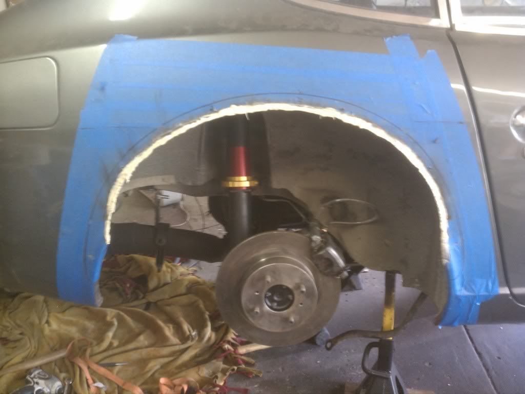

SUNNY Z Posted April 10, 2012 Author Share Posted April 10, 2012 (edited) well I got the rears cut, but not welded. Here's how I measured. Looked around on here, and found that I wanted to cut between 3 and 4". I settled on 3.5. So I made marks at the top of the fender (where the cut would be the deepest) and mounted the flares 1" higher than what I wanted to cut. I then marked it an inch all the way around, and tapered the edges. Then I cut the outer layer of sheet metal, and cut it again lower so I could access the inner layer to cut it. Here is the passenger rear at full tuck. All the stuff will be here tomorrow! Going to be a big day, have an O-chem test wednesday though.... school is taking the back seat to the 280 at this point.... Edited April 10, 2012 by SUNNY Z Quote Link to comment Share on other sites More sharing options...
RebekahsZ Posted April 10, 2012 Share Posted April 10, 2012 That is going to be beautiful. I love the color of your car with those RBRs. Quote Link to comment Share on other sites More sharing options...

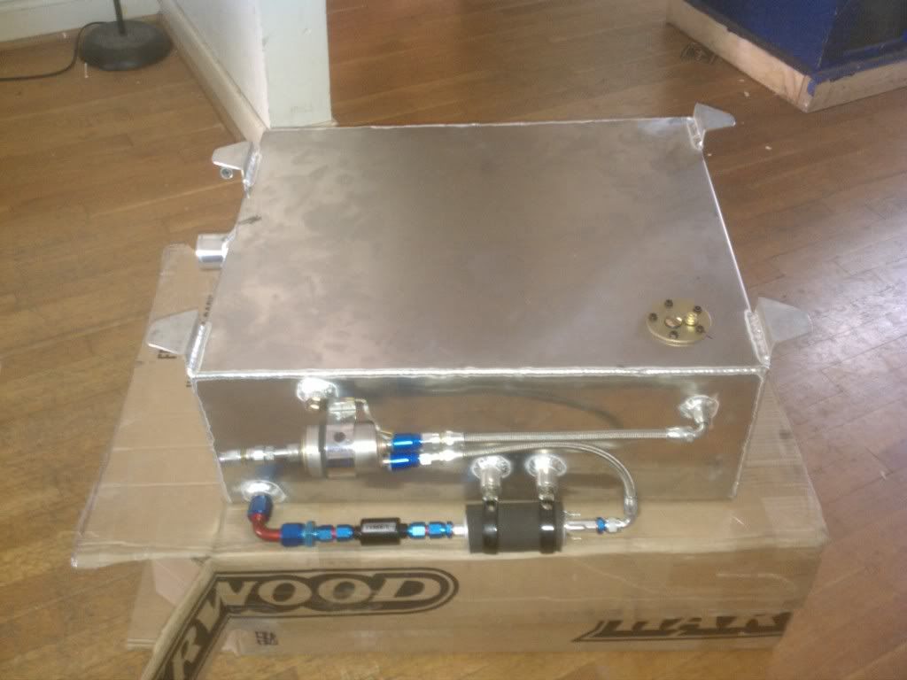

SUNNY Z Posted April 10, 2012 Author Share Posted April 10, 2012 Look who came to the party! Hopefully will have this lady running by this evening! Quote Link to comment Share on other sites More sharing options...
RebekahsZ Posted April 10, 2012 Share Posted April 10, 2012 Looks great. Think about changing that pre-filter before the fuel pump to a shut-off type filter; I wish I had done that. I am having a little sputter on right hand turns at a low fuel level, even though I installed a "sump" in my tank. So far, the sputter just lets me know it is time to go get more $4.07 gas. Please consider changing your Avatar ASAP. Those cheap allow wheels are killing me, and your RBRs are simply awesome. Quote Link to comment Share on other sites More sharing options...
SUNNY Z Posted April 10, 2012 Author Share Posted April 10, 2012 Looks great. Think about changing that pre-filter before the fuel pump to a shut-off type filter; I wish I had done that. I am having a little sputter on right hand turns at a low fuel level, even though I installed a "sump" in my tank. So far, the sputter just lets me know it is time to go get more $4.07 gas. Please consider changing your Avatar ASAP. Those cheap allow wheels are killing me, and your RBRs are simply awesome. yeah I agree on the filter. It was already at the shop and installed before i had that notion the way it is now, it'll take some mods to put one in. I think you mean my signature - and yes, I know, those wheels are hideous. Quote Link to comment Share on other sites More sharing options...

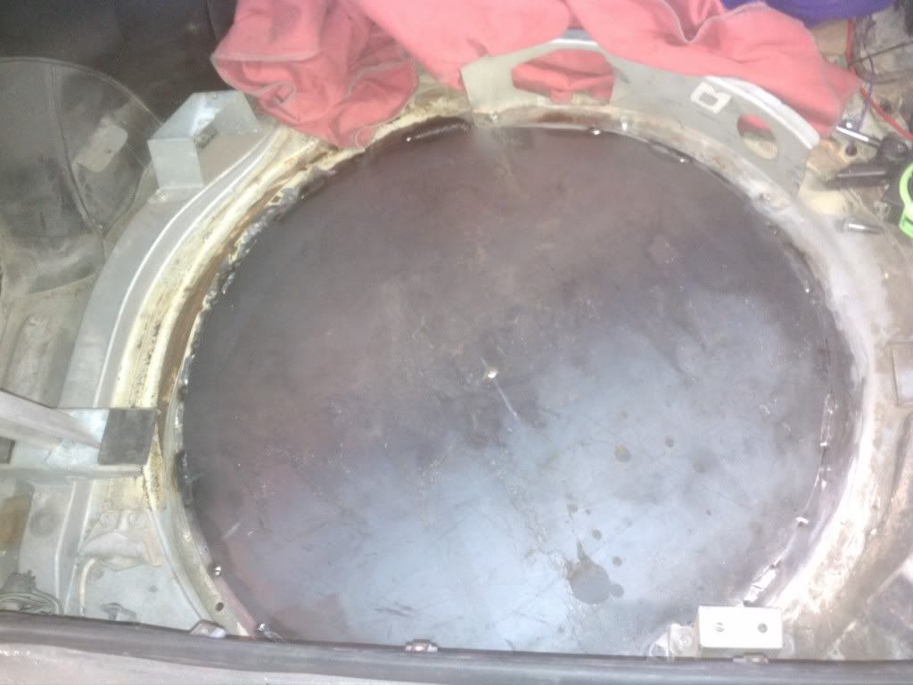

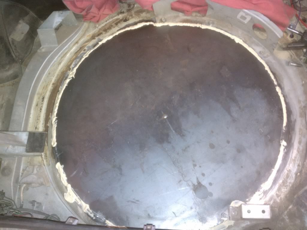

SUNNY Z Posted April 12, 2012 Author Share Posted April 12, 2012 Got the fenders and spare tire hole welded up today. Heres the piece i cut out for the spare tire, and welded in and then I used seam sealer on all of it and then stitch welded and seam sealed the fenders Quote Link to comment Share on other sites More sharing options...

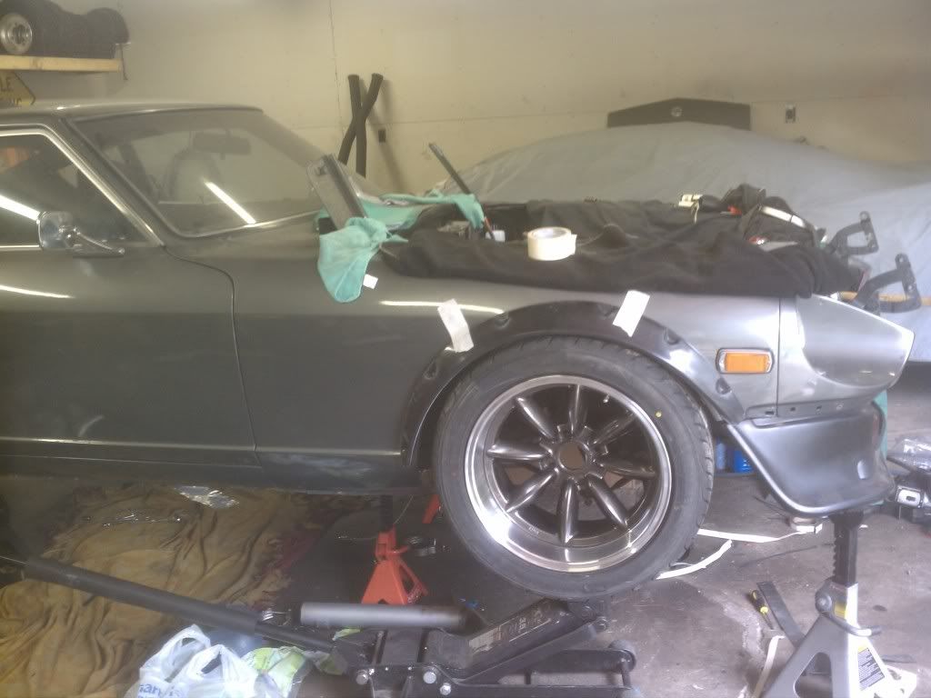

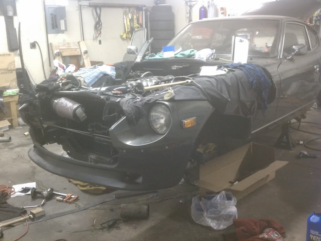

SUNNY Z Posted April 13, 2012 Author Share Posted April 13, 2012 Front fenders / air dam are trimmed this is ride height-ish. maybe a bit low Quote Link to comment Share on other sites More sharing options...
