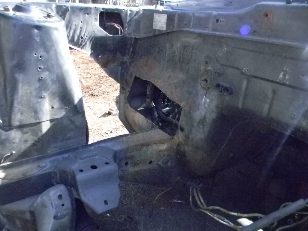

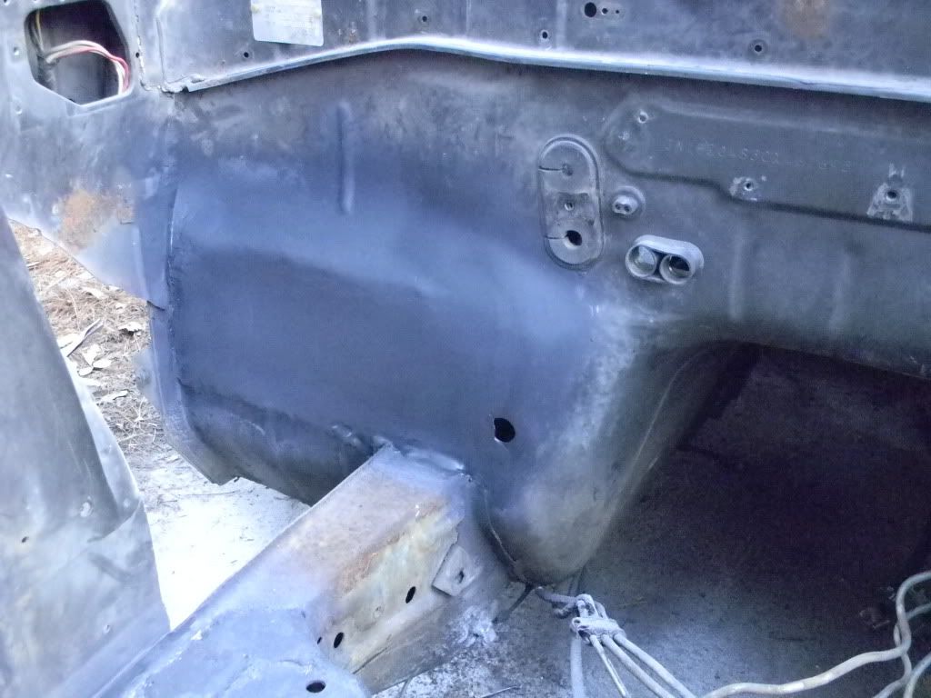

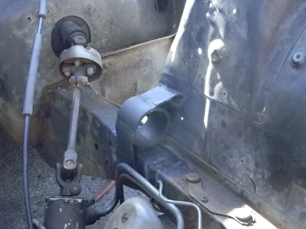

richracing Posted January 17, 2011 Author Share Posted January 17, 2011 I took the motor set back out so i could finish the mounts, patch some rust, and paint the bay. 2 out of 3 complete... Quote Link to comment Share on other sites More sharing options...
slyhog22056 Posted January 18, 2011 Share Posted January 18, 2011 Just to pass on some advice... do you see the area of the frame where it meets the firewall??? there is a triangular section there that needs 1/8" plating on both inside and outside to help carry the weight of the engine. AFter you weld on the plate run some 1 x 1/8 strap on the firewall side to help spread it out on the firewall. I learned this from a guy here locally that dropped a 351 windsor in his and the frame bent right up against the firewall from the extra torque of the bigger motor. I pulled my 302 out and plated mine after seeing the damage done to his. Quote Link to comment Share on other sites More sharing options...
richracing Posted January 18, 2011 Author Share Posted January 18, 2011 Thanks for the advice. I think I get what you're talking about, but pics would be awesome! Quote Link to comment Share on other sites More sharing options...
