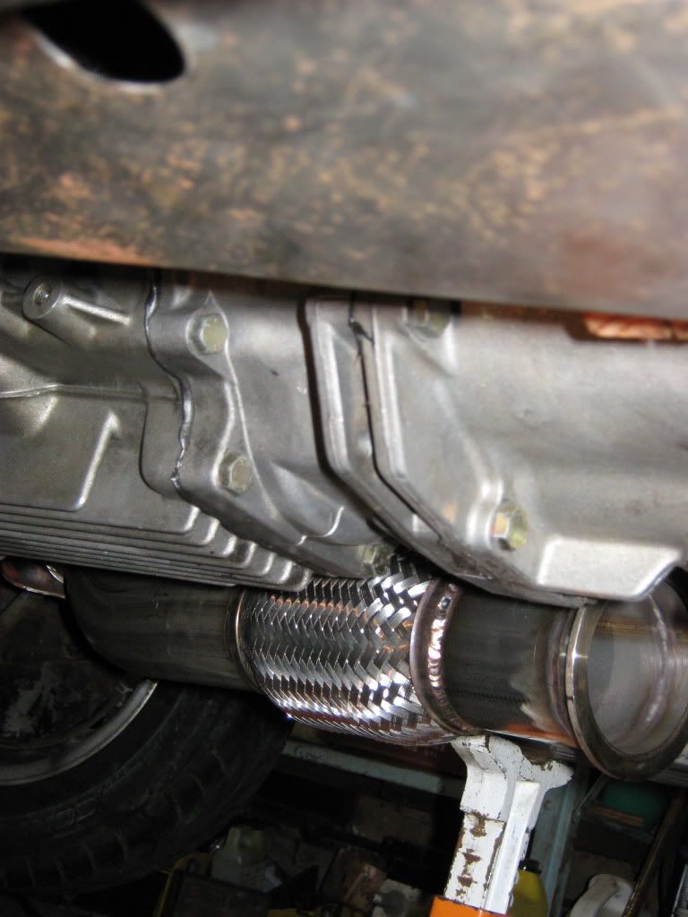

Can't figure out your engine mounts. What's going on there?
Photos 10,11, and 32 show the mount. The mounts are trd mounted to 1''x3''x1/8" box tubing crossmember. The brackets are angle and round tubing boxed to the angle iron.If anything they are overkill. The angle is 3/16''.

Added some desciptions to pictures. I did all the fab work and welding myself. Rear suspension was narrowed 3.5''. I was not trying to recreate the wheel so I moved the control arm mounts inboard. Fabbed up cromoly control arms and moved the wheel wells inboard also. Replaced both floor pans.
the front frame rails were severely rotted from the inside. Grafted in 2.5 x 2.5 x .120 box tubing to replace them. Drivetrain is a 2jzgte single BW 85/73 turbo motor and v160 6 speed tranny driving a r230 rear end.I have been woking on this car for about 1.5 years. Lots of parts and work still needed to complete. This car came with a 280zx turbo motor when I bought it. Not the best conversion I have seen. Wiring was a rats nest. A fire waiting to happen. Hope you like it. Thanks
Sick build. Looks like you have a lot of work put into the suspension and fab. Exhaust clearance? I'm diggin your welds. Keep it up and make sure this thing gets up and running on the streets. Should be one sick fast Z.
