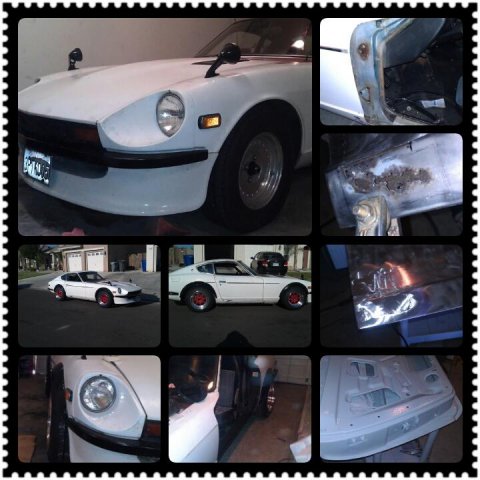

Ouch, yeah a little rust like that isn't going to be fun to fix, just remember you're going to be welding THIN metal and that you need to clean up the rust first. Hitting it with a wire brush on a grinder is a good way, just be sure to wear a good set of goggles/full face mask, to clean it all up.
Butt welding, or overlapping both work fine, but just take your time and make tons of little welds to keep things from warping or burning through. read up on how people have done it.
The Floor pans often rust because of a leak under the cowel in front of the windshield. Cleaning out all the crap in there and resealing it with a good Sealant will help prevent it from happening again. Underneath, consider paintng Por15 (or some other rust inhibitor paint) over your repairs, then some regular underbody coating. The Por 15 will help prevent any rust under there from continuing. Inside, sand it down and repaint it with about any matching paint should protect it well enough. You just don't want to leave exposed metal/welds since they'll rust quickly again w/o treatment. Inside it's a good idea to remove the Tar sound deadening crap Datsun put down, just to be sure you don't have any other spots. Dry ice makes it super easy in the warm weather. Colder temp areas <40 degrees you shouldn't have much trouble. I used a flat screwdriver, mallet and a thin metal paint scraper trowel.
